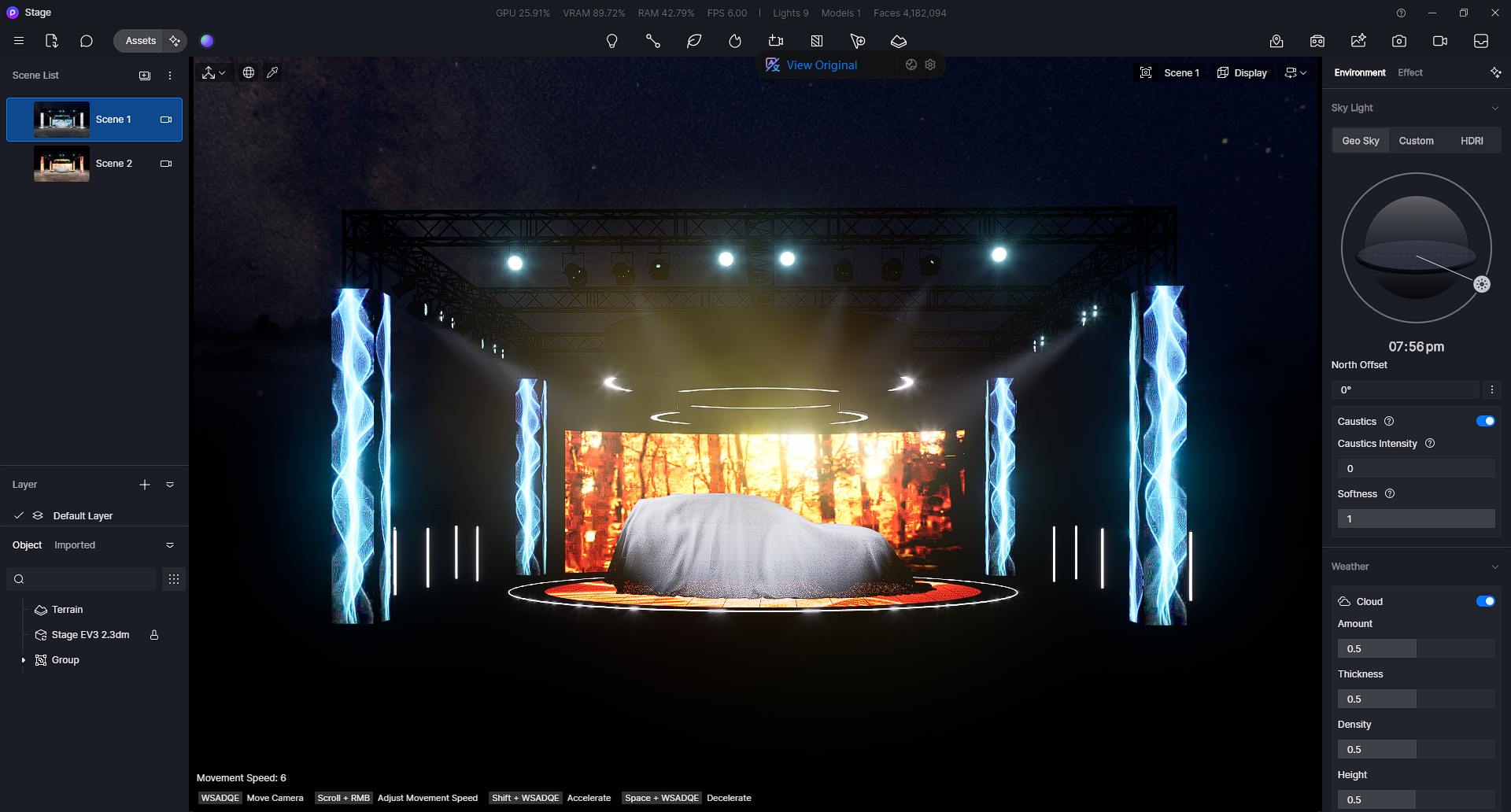

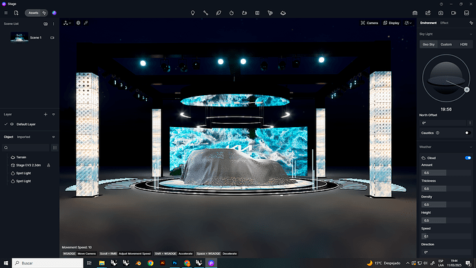

I’m having trouble applying a texture that simulates the pixels of a 50x50 LED module. When I zoom in or out, it creates an effect that makes the texture lose its mapping and appear to grow and shrink, as shown in the attached images. What solution can I use in this case? When rendering an animation, this flickering becomes noticeable

The texture is simply a custom alpha with a map simulating the pixels of an LED module.

To create the effect, I use two surfaces, one in front of the other. The first one has a custom alpha with the texture that simulates the pixels of the 50x50 LED module, and the second one displays the image or video for the screen.

I’ve already tried all types of mapping, including surface, and the problem is much more noticeable when I have an multimedia emissive material with a video for the screens in a nighttime scene.

Thank you for sending your files. We’ve reproduced the issue: the custom alpha material template doesn’t function correctly. When set to ‘Transparent’, only the platform screen reflects the pixel texture. To further investigate, could you please provide your Rhino file? We’ll use it solely for testing purposes and delete it afterward.

We have confirmed that this is a known issue, fine constructs may flicker most especially materials that are set in custom alpha and with fine details (just like the map you have inserted). For now, the workaround is to disable:
- FPS Booster
- DLSS
Although in the preview window, when FPS Booster is disabled only large blocks of these patterns disappear and the abnormal size change is still evident. We also tried to render the video with these features disabled.
