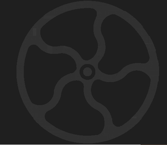

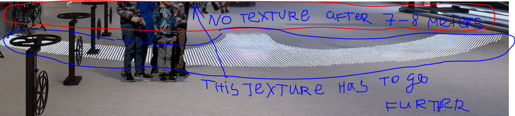

I’ve got the situation then PNG (with alfa layer) texture doesn’t display from a distance. First 7 meters of the texture displays and after doesn’t.
The PNG texture applied on a surface and imported from Sketchup to D5 render separately. PNG texture has tiny dots pattern. Other textures with a bigger pattern displays with no problem.

On the viewport and on render it look same :smiling_face_with_tear: It does not become normal on rendered picture.

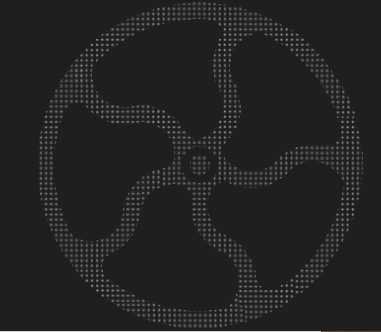

ok, I solved the issue by increasing the radius of every single dot on the texture.
