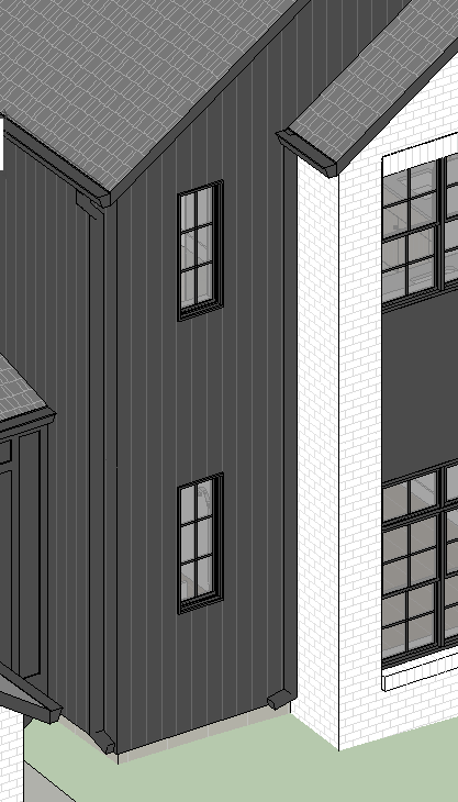

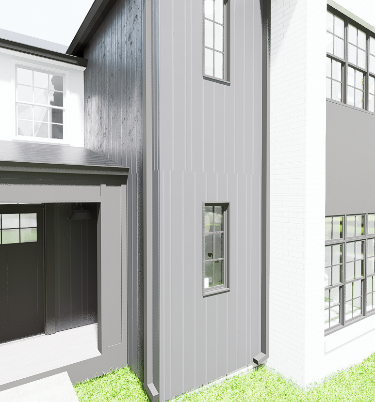

Is there a way to better sync the texture alignment between Revit materials and D5 materials? We model exterior walls floor-to-floor, so they are split vertically at each level. Textures are aligned properly in Revit, but because the walls are separate objects, I guess, D5 seems to randomly shift the material. Haven’t seen this issue in Twinmotion or Enscape, but as we shift over to D5 it’s become problematic.
Is the best way to avoid this, at least in this case, to model the entire exterior wall as one object for the entire height of the building? Or conversely, creating numerous duplicate materials for each wall segment so they can individually be shifted in D5?

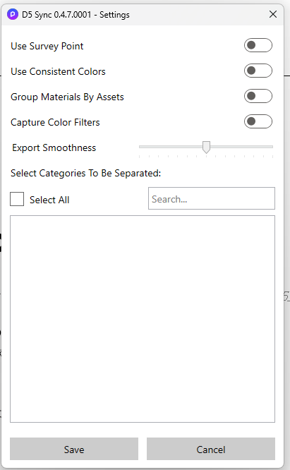

D5 Sync 0.4.7.0001

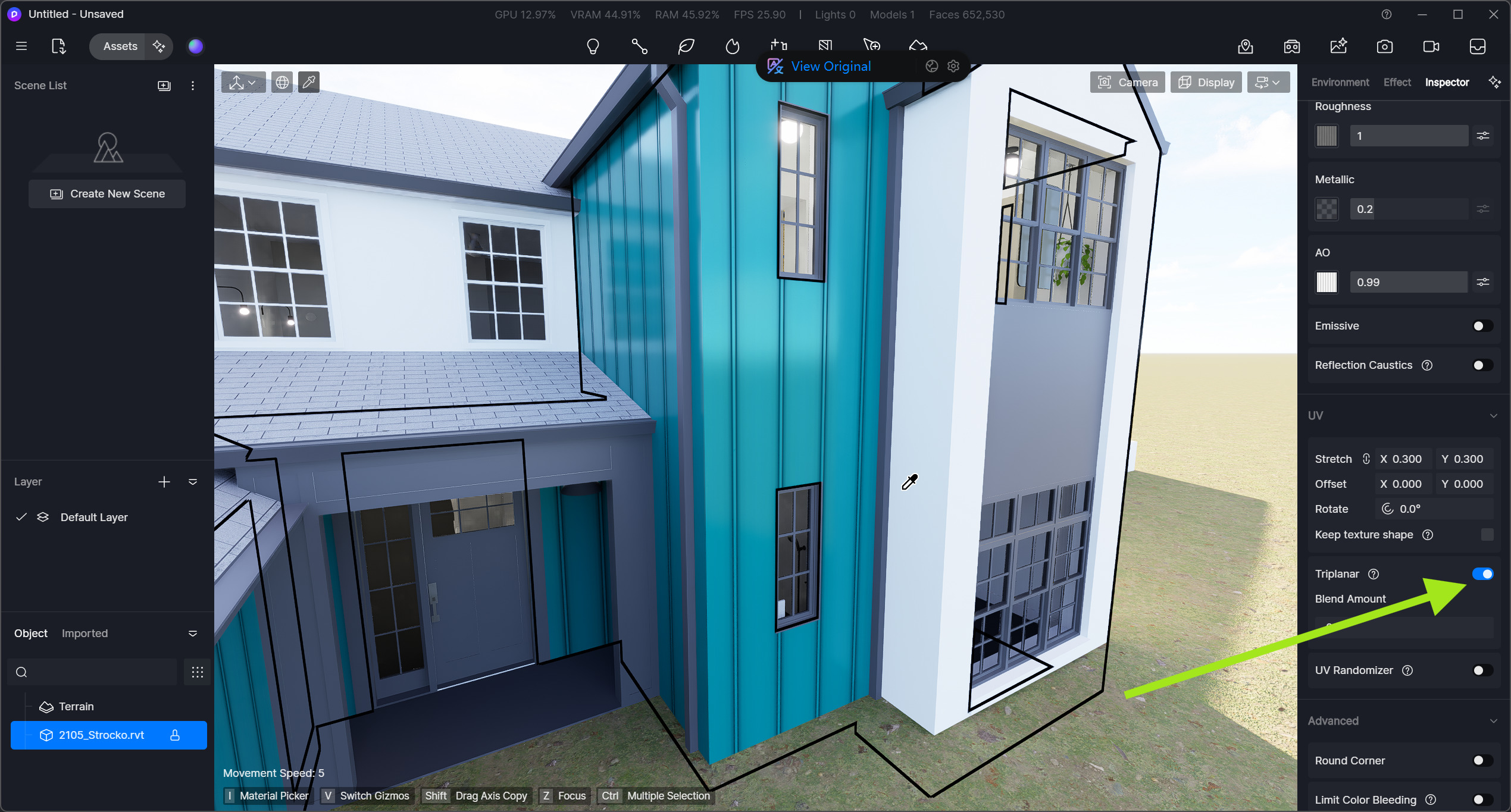

Hi @sloan
Please enable “Triplanar” in the material settings.
That solved it, thank you! Is that option not compatible with textures that have displacement maps? My original texture had displacement, and the triplanar option wasn’t there, but when I changed to a different texture without displacement, it came back.
Hi @sloan
Currently, triplanar mapping isn’t available for all Material Templates. We may add more template categories that has the Triplanar Option in subsequent releases.
