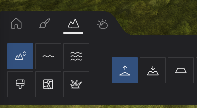

Is it possible to change the terrain height in D5 render, similar as it is in Lumion?
I would like to create hils …
Or would I need to create them in the modelling software and import to D5 render?

D5 currently does not support the ability to create terrain. Therefore, you will need to create the terrain in your modeling software first, and then import it into D5. ![]()
