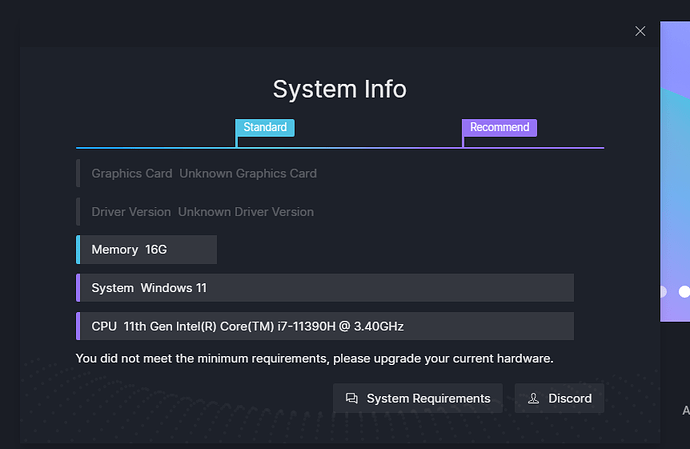

Hi, I’m trying to install but I don’t quite understand why it doesn’t let me run the software. Could you please check?
Thanks
