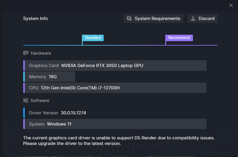

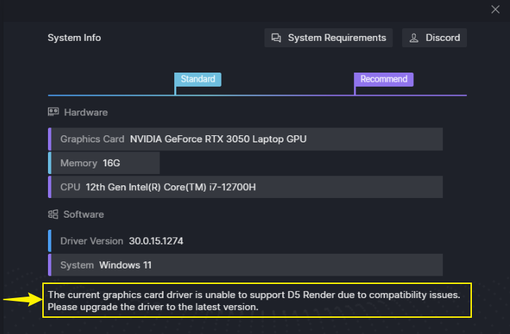

Hi, I’m trying to install but I don’t quite understand why it doesn’t let me run the software. Could you please check?
Thanks
Hi there. I apologize for the inconvenience this issue has caused. Usually, a greyed-out row means that your graphics card driver is not updated. You may want to update it in your NVIDIA GeForce Experience application or directly through NVIDIA’s website. Thank you.

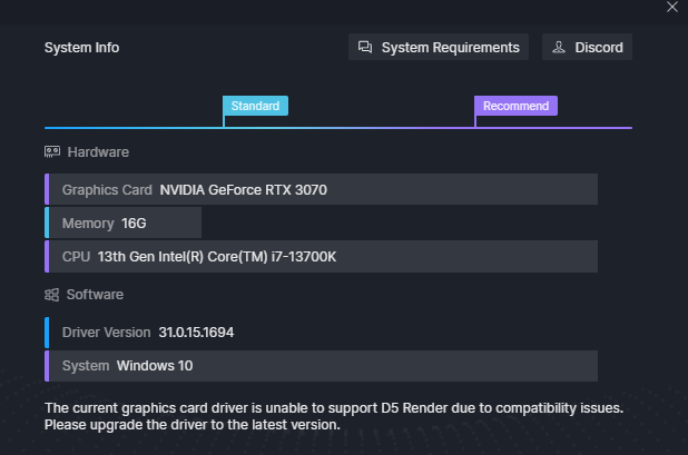

Hi @huj7103
Please check the prompt that is evident on the bottom part of the pop-up:
  • It seems that you need to upgrade your Driver Version. You may upgrade it via the NVIDIA App and please avoid the 576.02 Version

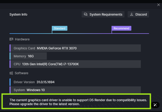

Thanks
Hi @indisandyakala
Your driver needs to be updated. Please check the note or prompt below System Windows
