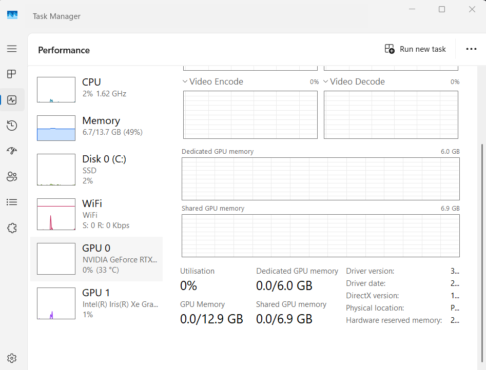

Help!! how to fix it! ive followed everything, but its still not working. huhuhuhu
Hi there, I apologize for the incovenience this issue has caused. Can you provide me with the following information? You may refer to the Images provided. Thank you~
Hi there, thank you for the screenshots. It seems you accidentally cropped the GPU details. I would also like to know your device model and GPU, kindly resend the screenshot showing the GPU information.

Hi there, thank you for providing the following images and information. First and foremost,
Can you check and make sure that D5 Render is utilizing your GPU 0 which is RTX 4050 instead of the GPU 1 (Intel)? You may open NVIDIA Control Panel and look for this option.
If you are unable to located the Screen Mode Manager and select Solo GPU, you can also disable it in windows device manager

I have noticed that your graphic card driver is not yet up-to-date, the new version is currently at 566.03. You may want to refer to this link for more information and in-depth instruction: How to view and upgrade graphics card driver? | User Manual
