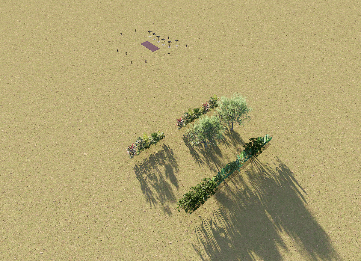

Hi,
after the last update, i have several issues when i synchronize my drawing from Cinema4D to D5…
When i finish my drawings into C4D and send it to D5, everything is OK… the file shows up normally. But when i close everything, and start again, synchronize to D5, the file in question is not showing up but all the D5 features, models and lights are there…
I have this problem on all my projects . please find a solution
