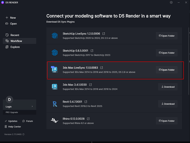

Hello. Currently the latest version of the Real Time Live Sync plugin for 3ds max is able to sync the display and hiding of layers.
