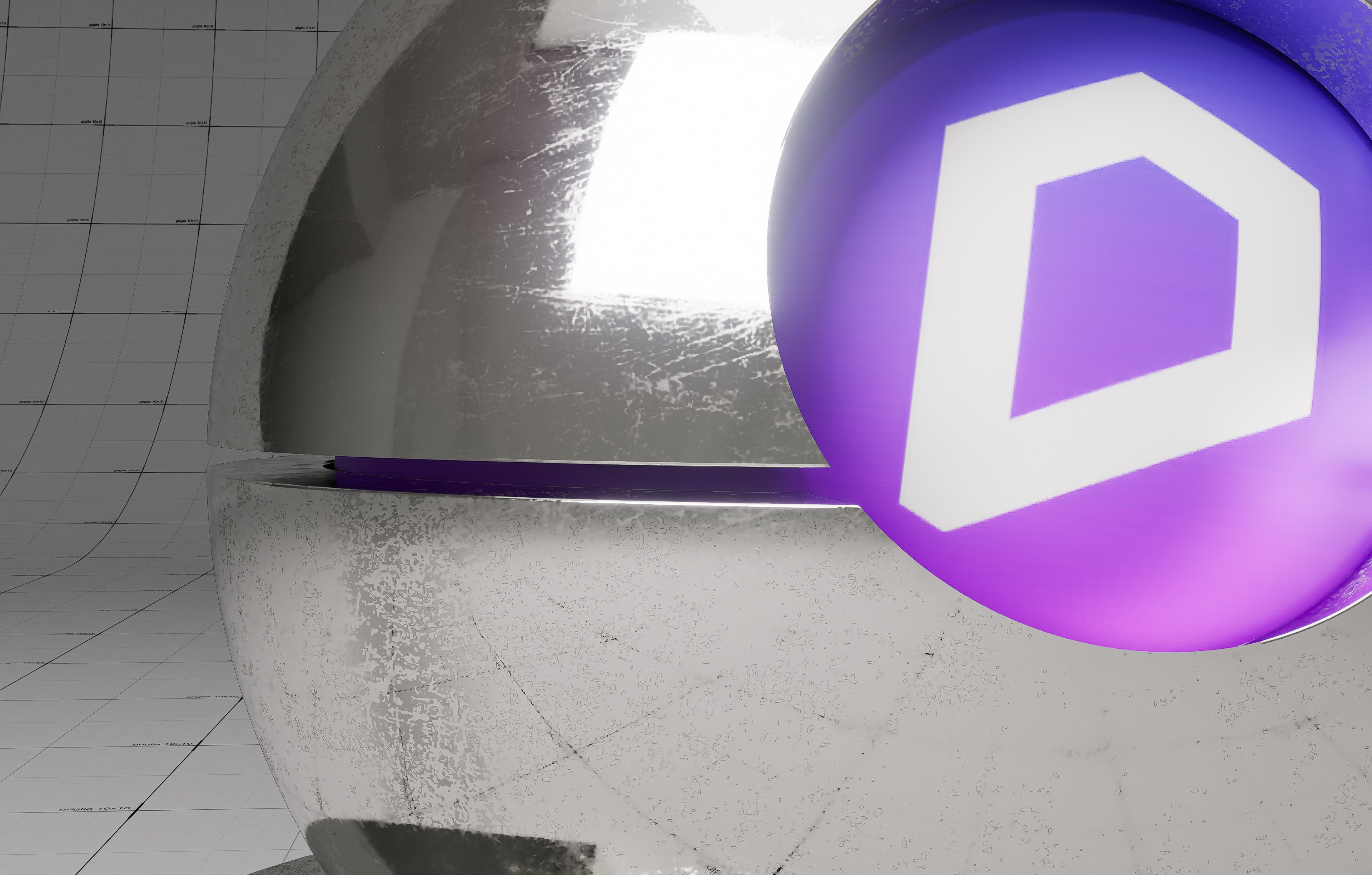

It can be done by working with good maps
Base material
Surface Imperfections 01
Surface Imperfetions 02
You got this result with the roughness map right?
yes. with a good grayscale map + Normal map
Yeah I do this too, but if we could be able to add a Imperfection map + normal + Specular + Roughness
It would increase the realism

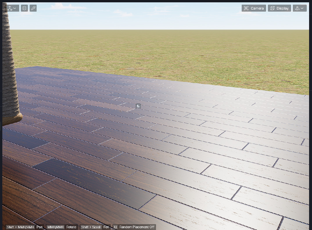

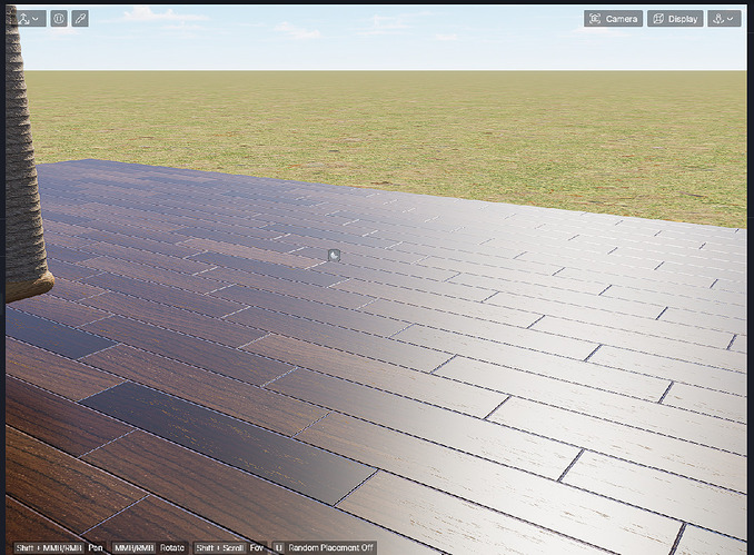

How exactly is that done if I may ask?
with a good grayscale map (in Roughness channel) + Normal map
new material:
Solo roughness map
So one hypothetical workflow would be to grayscale my current normal map in Photoshop, then add it to the roughness channel?
NO no.
you don’t have to turn a normal map into grayscale. You have to have a grayscale map, a good one, to load into the ruoghness channel.
For these micro grooves I don’t use a normal map, you might get the power of the normal map wrong and have the wrong result.
