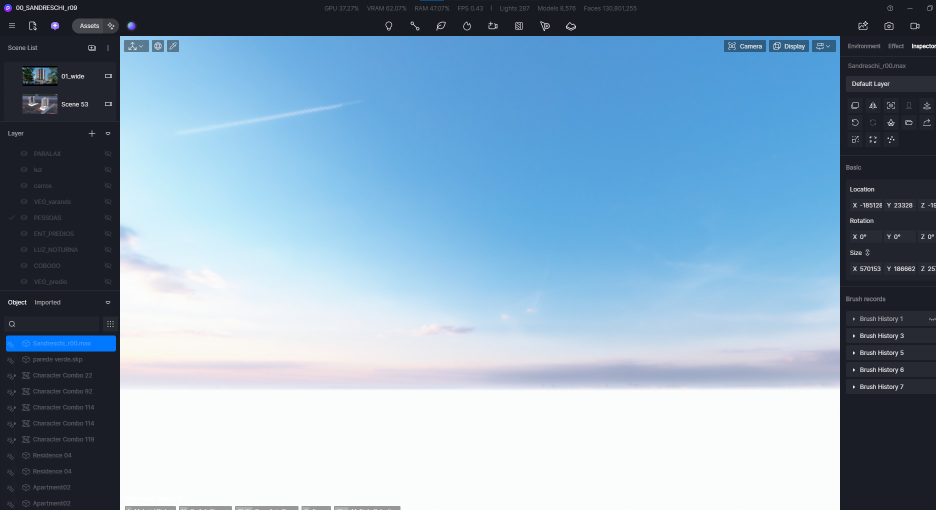

i was working on a project yesterday and all was fine. But this morning, when opening the file, its unusable, the file is stuck, the viewport has less than 1 fps
Ive turned off all the layers and still the same.
the drivers, software, file, are all the same from yesterday, i dont have any ideia why its like this

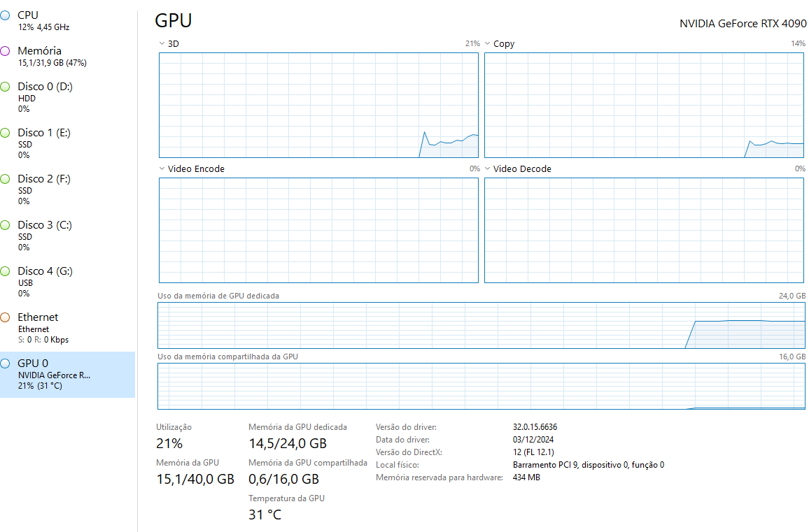

  • Is there any reason as to why you’re keeping your drivers outdated (still in 2024) :thinking:? I recommend updating it and ensuring that game-ready drivers are selected, considering that you have files that are massive and bigger than 5GB
yes, restarting gives me the same result, file still stuck at 0.3 fps

i rolled back my drivers because i was stil having those problems where the files starts to stutters for 5 - 10 minutes and i cant to anything, not even saving ( i have a post here about it), Those 2024 drivers helped a little with those problem, but still happens time to time. Any driver from this yearm studio or game, gives me that bug.
