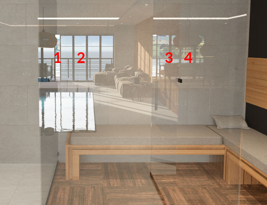

This is strange behaviour.
At point 1, it is a direct reflection and no glass in between the glass of the reflection and the picture of the mountains outside. The door is slightly opened at this point.
At point 2, there is glass again, and no reflection.
But at point 3 and 4 it is one or two more reflections (bounces) and the picture of the mountain is visible again.
EDIT:
In the preview window, the first reflections (1 and 2) work and 3 and 4 dont appear, but the last two I understand.

Let me make the situation more clear.
1 and 2 are visible in the preview window, 3 and 4 are not. This is logical because of resources during preview.
But in the final render, 1 , 3 and 4 are visible and 2 isn’t, even though 3 and 4 have an extra bounce and 2 used to be visible in the preview.
So this is not normal/correct behaviour and should be fixed.
EDIT:

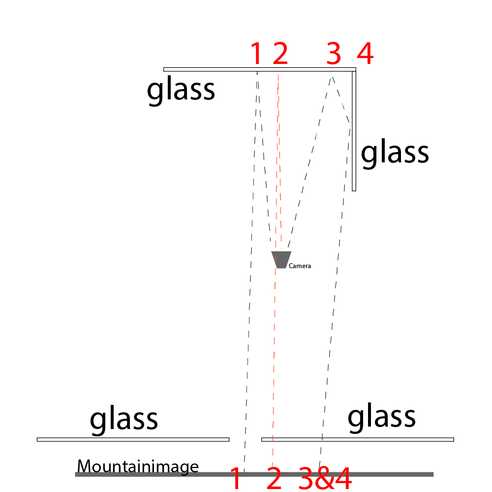

Even more explanation
1 is a bounce via the glass in front of the camera, directly to the mountainimage (visible in preview AND render)
2 is a bounce via the glass in front of the camera, THROUGH glass behind the camera towards the mountain image (visible in preview NOT in render)
3 and 4 are both bouncing at the glass in front of the camera and the glass visible next to it, then moving THROUGH the glass behind the camera towards the mountain image. (visible in render but NOT in preview)
