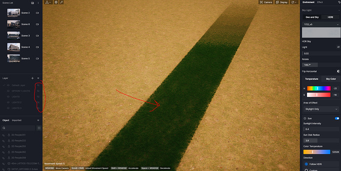

This is probably the third or forth time I encountered this issue. I was working on the file for days and all was good, then suddenly I see this random grass that’s placed in random locations and I am not able to delete or hide it at all. and it shows in the renders.
I’ve tried hiding every layer, I deleted everything in the model, and the grass still shows.
This happened in other projects in different files as well.
I have the latest D5 update.

There are no hidden surfaces in my 3D model, and I didn’t use the scatter tool.

There is a grass material in the model placed correctly, I reset that material and nothing happened to the random grass object.
also, it seems that I can’t even inspect/select the material on that random grass.
But I noticed, if I keep selecting and unselecting layers one by one (I did that multiple times) it fixes itself, and the random grass object disappears… but it doesn’t always work.

This is very strange! When I opened the file, it looks different:
But as you said, it looks like the issue is from the model Site.3dm. I deleted it, the grass disappeared.
But its strange that I can see the grass from a model that is hidden.
