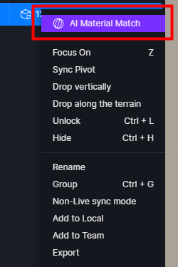

D5 2.6 added material template recognition function. After importing the model in the scene, select the model in the object list on the left sidebar, right click and choose AI Material Match, it will automatically give the suitable D5 material template, covering most of the commonly used material keywords and texture types, and achieve intelligent recognition without waiting under the premise of guaranteeing the recognition rate. But it doesn’t support directly replacing the materials in the D5 assets library, and the D5 assets library can’t be exported to other software for use, because they are encrypted.
