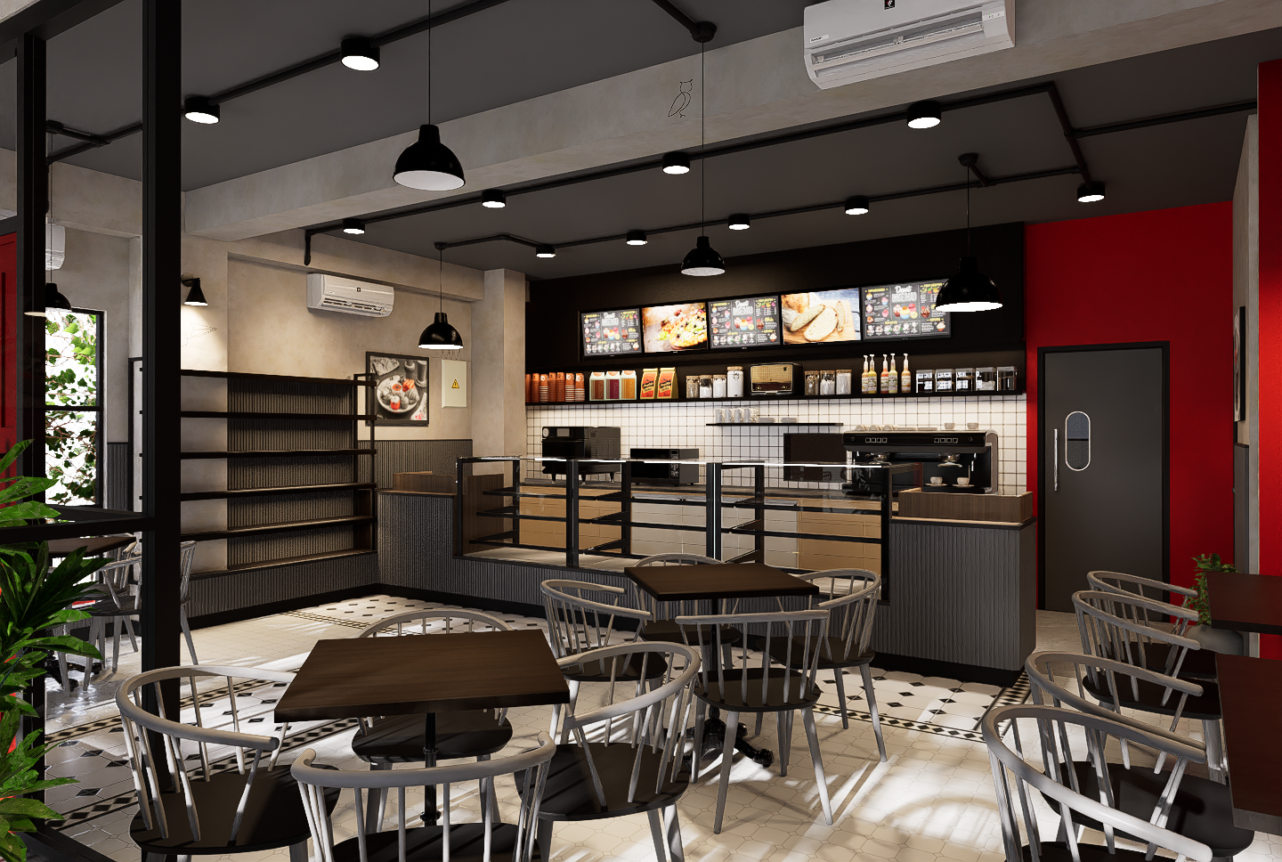

I have updated to D5 2.7 a couple of days back. Today i opened an older project and the D5 render window is blotchy with colour burns (attached img). When i render the view, the output is fine.
What is the problem here? Is it D5 or its my GPU acting up? Cause i opened another (much simpler) project and the D5 render window is just fine showing the colours correctly.

I also noticed that it took longer to render this view than it did before.
Hi, I had the exact same thing you explained. All I did was upgrade the graphics card, GTX 1070 16GB.
Many colleagues had the same problem, and I already suggested they update the card, which can then be updated in two different drivers

Hi! riccardofortelli’s method may help you. If this does not work, please tell me. BTW, Which version of D5 was this scene previously created with? Maybe send your scene file to us. support@d5techs.com
