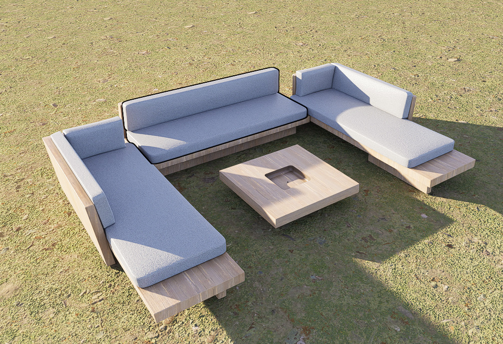

  2. When object or material is selected it is visible in final rendering too as black outline.

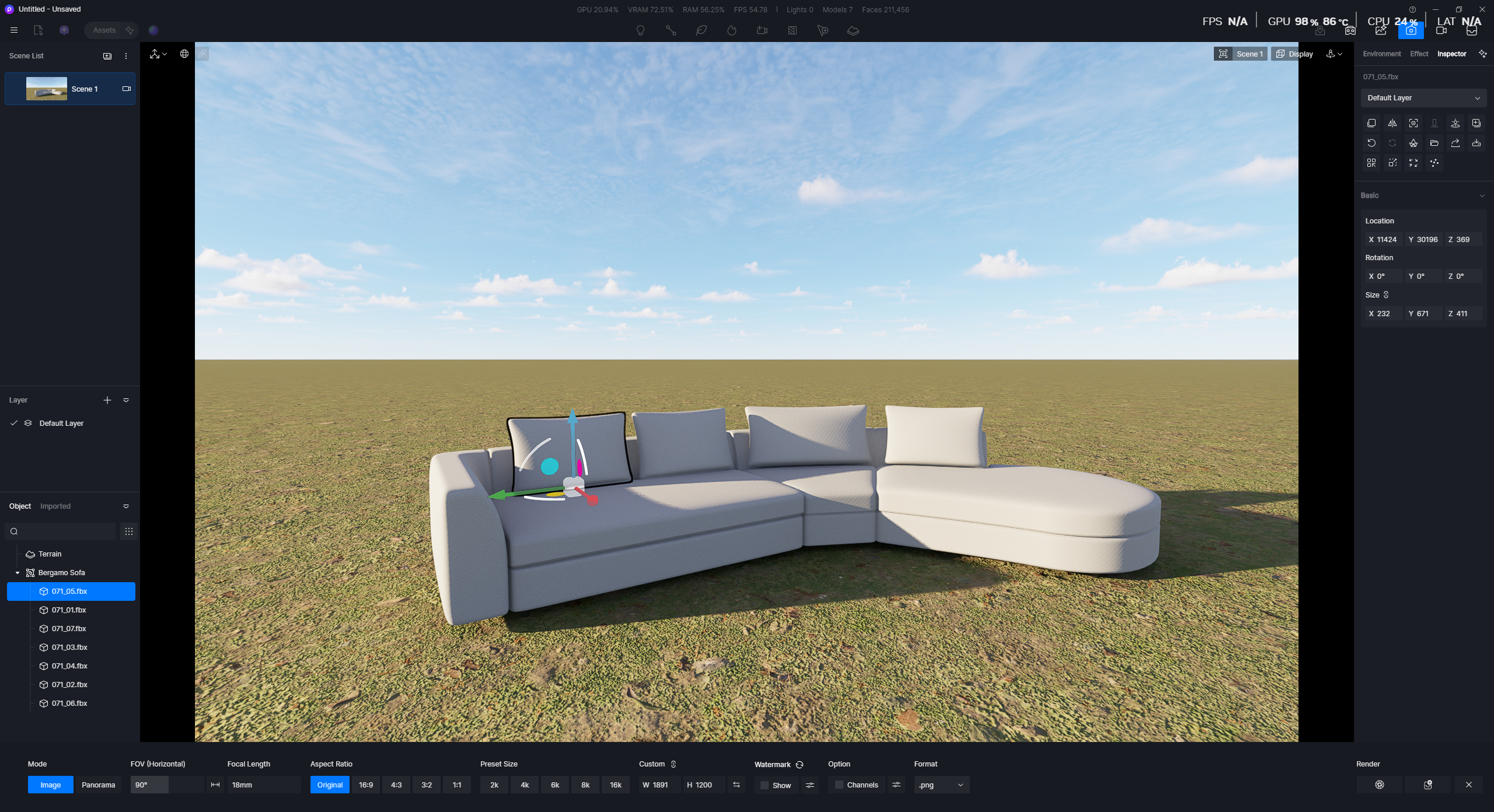

But I would like to mention no. 2, I tried it on my end, selected the model (which prompted the outline) > and rendered it
Hi Clov,

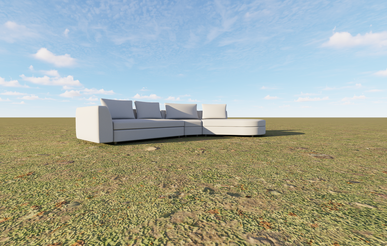

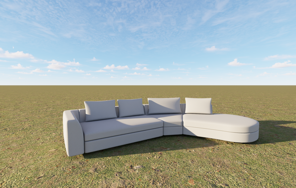

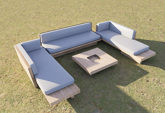

If material is selected it is visible in rendered image :

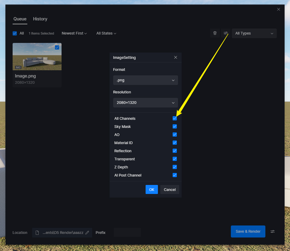

I also noticed that selected channels are not stored in scene file. Every time scene is opened channels are always set to AI Post

I’m pretty sure the material can’t be selected in the photo image window (the Material Dropper and shortcut are disabled when in this state), and you can only select the individual object of this asset.
Can you clarify how you did the process on your end? I would like to replicate this issue.
Note: I am using online assets from D5 Library.

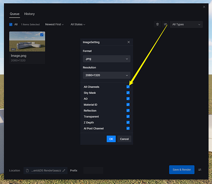

  • As for your other concern, I suggest saving the Scene in Render Queue so you can save the channels that you need.
Strange but it works fine now. Maybe it is random issue.
As for render channels I mean that after D5 restarting it always has AI channels selected by default even if we saved scene without any channels enabled.
Hi @Smolak
Are you suggesting having it disabled by default? I think the AI Channel Map is enabled by default to improve selection when AI Tools are being used.

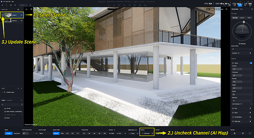

I just confirmed with our team that the AI Map and other AI Channels are controllable and their settings are unique to each individual scene. For example, if you enable a specific channel like Material ID in Scene 1, those settings will be retained only in that scene and will not affect any others. :slightly_smiling_face:
  • This should be the normal process, but as I have tested it, it seems to be doing otherwise, and I have reported this issue further to our team.
  • For now, upon reopening your file, just click on the scene again, and the changes should reflect.
