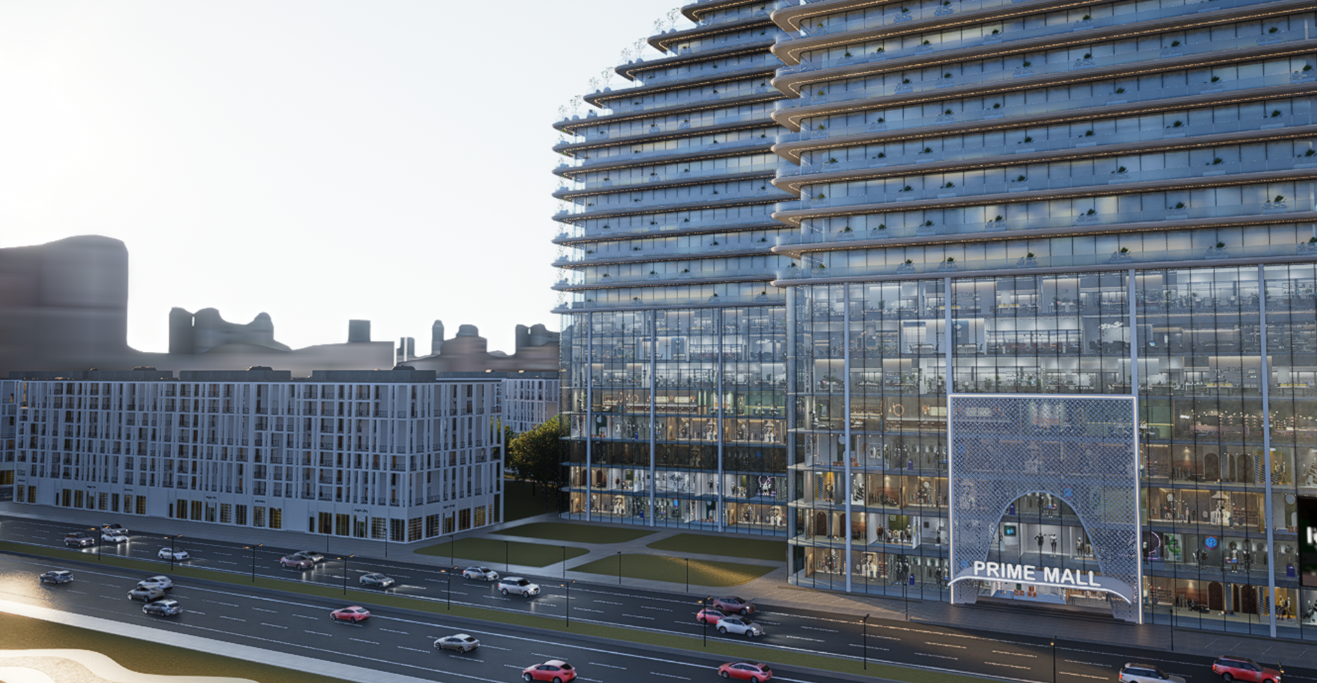

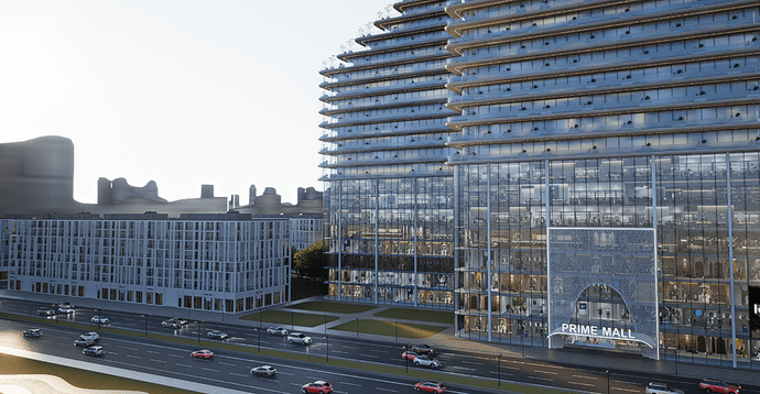

Hi , im working on a project from 4 days every thing was good now i was going to wrap up project today but when i open the some materials will apear blur like background backdrops road texture and d5 buildings window parallax not my main building . i have try to restart d5 and my pc as well but still blur texture . can you help what i need to do . this very important to complete this but with issue i cant .

Have you tried opening the *history file?
It’s easy: open the D5 launcher and, in the project list, right-click on the thumbnail of your project.
A dropdown menu will appear, and there you’ll find the option to access the history files. Click on it: you’ll see your project with three different versions saved at different times.
Usually, the most recent auto-save opens automatically. Check if everything is fine; if it is, create a backup.
Then the corrected file you checked will open again.
