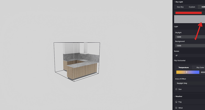

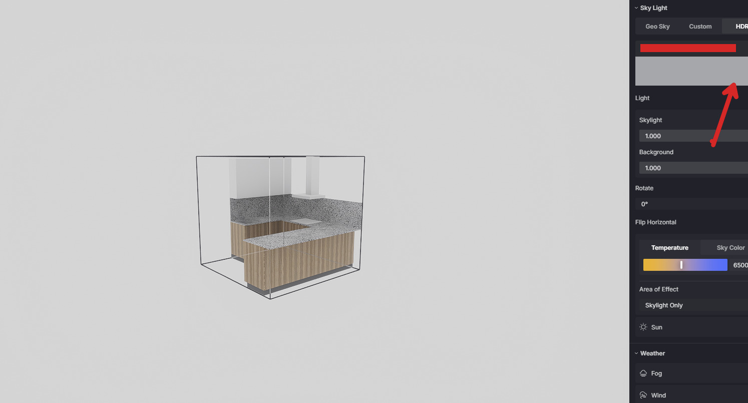

hi Guys!
I did it
I used a custom “WHITE HDRI”

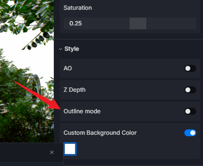

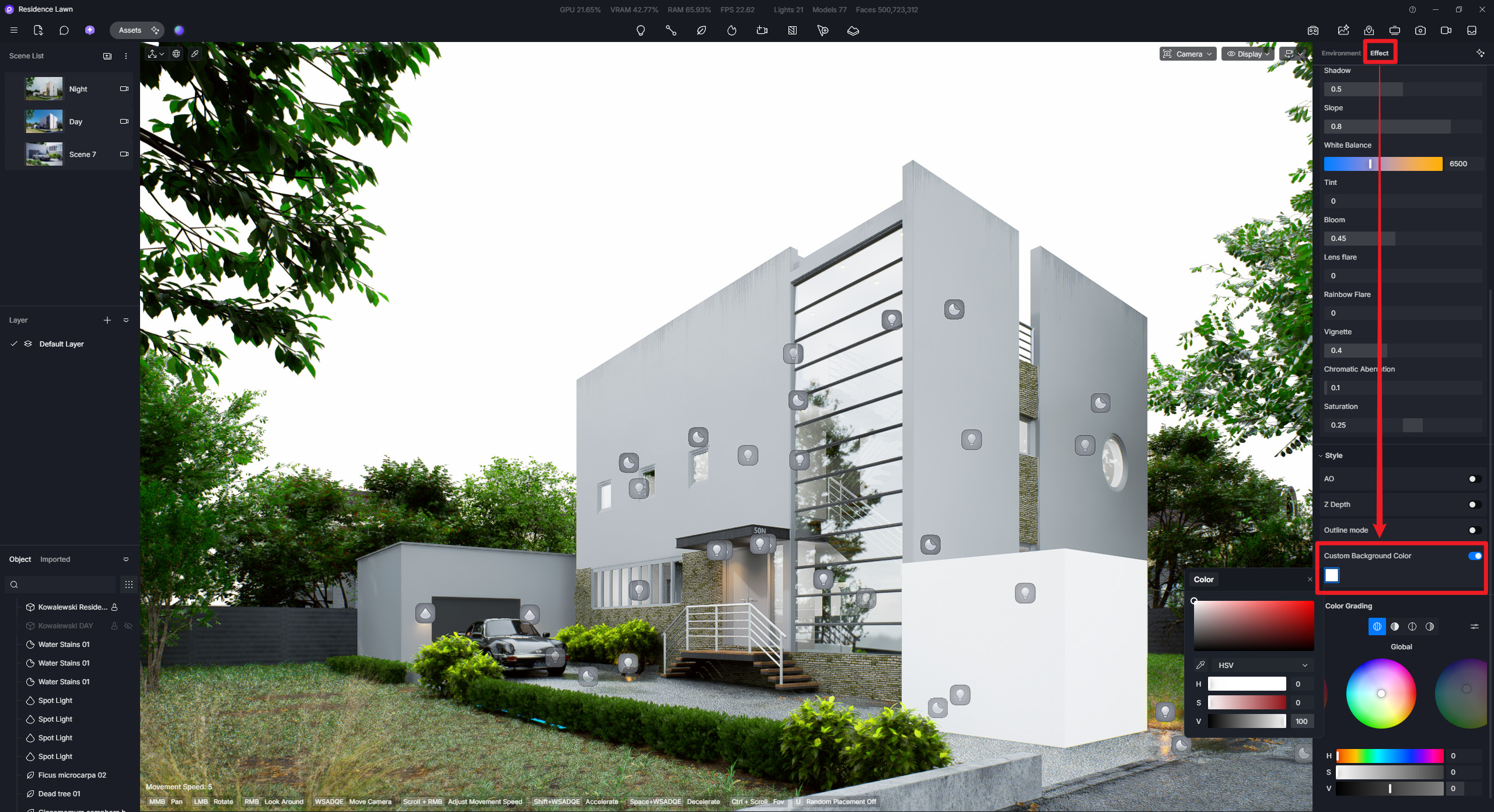

Hi @jgarcia.arquitecto
If you want to have a white background, we recommend using Custom Background Color.
  • Effects > Custom Background Color > Set it to white or whatever you like
  • Just ensure that you have disabled the outline if you don’t like having it shown.
