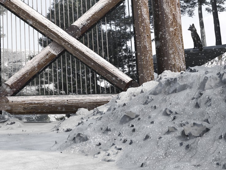

Snow models don't display well
Tell me what I’m doing wrong…
why are textures displayed poorly on models?

These are the new snow models from the library. The textures on these models are distorted. (Snow 09)

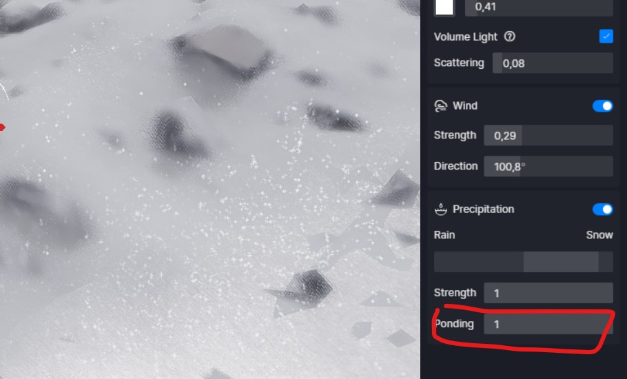

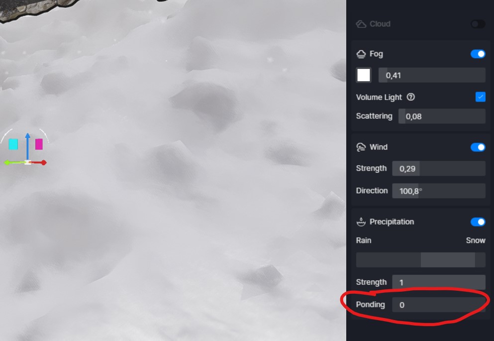

When changing the “ponding” parameter, noises and distortion of textures begin to appear. I have noticed this so far only on snow textures.
