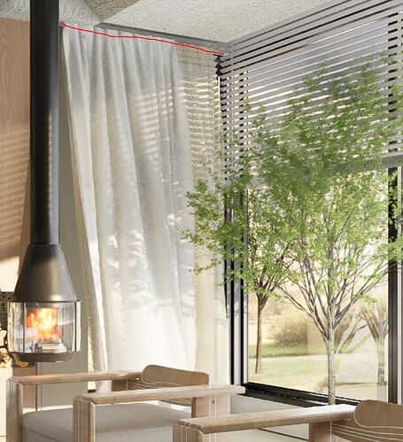

+)Curtain size can’t be adjusted to the ratio I want, is that right?
2>
When placing the curtain in the center inside the curtain box
Can I make various snaps? (center snap, etc…)
I want to adjust the location in detail, not like the attached image.

2>
If the curtain in D5 is a whole object, you are unable to edit it as separate parts.

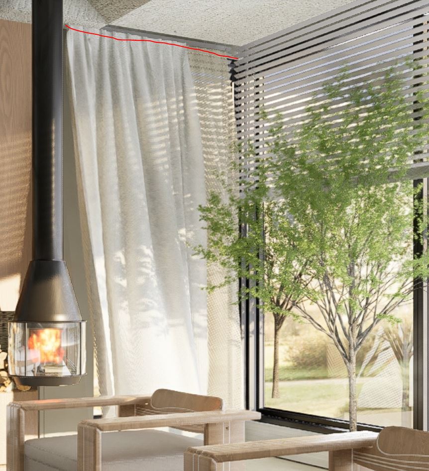

I tried to adjust the size according to the attached image,
but it couldn’t be adjusted to the ratio I wanted. Is it because it is a free version (for example, a vertically narrow and long shape/a different ratio from the existing asset)?
