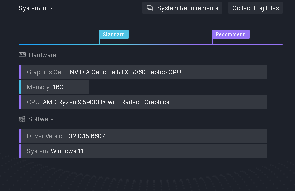

System Info

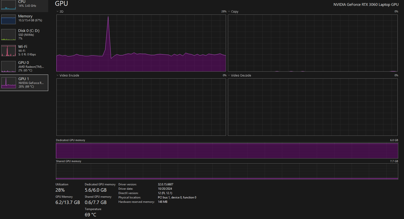

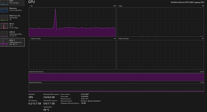

VRAM - please OPEN your D5 File when you access this portion

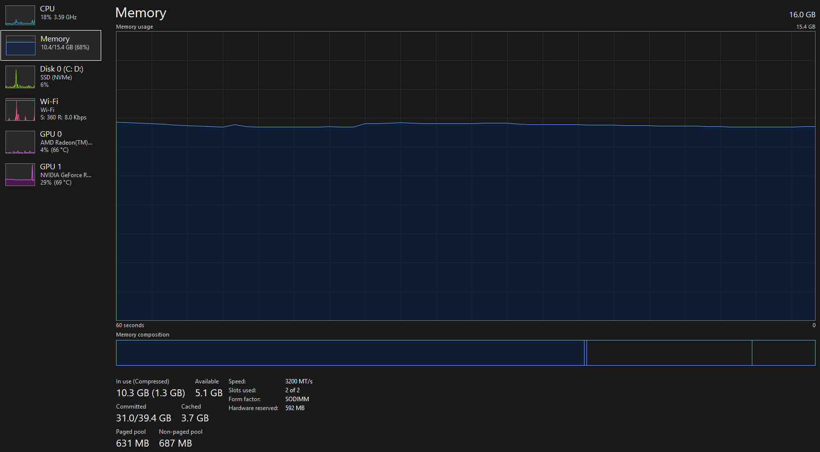

Memory Speed
Hey @Clov
This happen only for this specific file. I have attached all the things you asked.
Hope this helps in understanding the issue.
Thanks for sending these images. There are only two things which concern me:
Driver Version - Your Driver version is still from last October 2024; it might be best to update it.
VRAM - You only have 6.0 GB VRAM, which may be too low if you both open D5 Render and SKP at the same time thus, susceptible to crashing.
