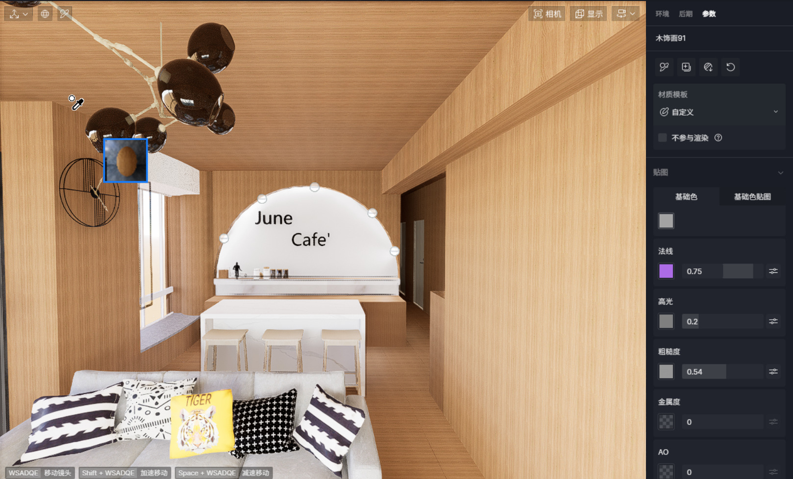

As the picture shown above, I can’t give a material to the floor as it will affect to the walls and other items. some models in my Sketchup can do it seperately, but some can’t . in this case. my floor just can’t edit the material alone. Anyone have solution for this?
please share your opinions. thank you very much!
Hi~ Maybe you make your models in one group. You can distinguish each material in Sketchup first and then use D5 to give the material.
            Please give the walls and floor different materials in SU.
