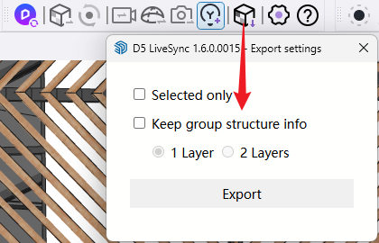

Hi @alhilalqa
  • You may need to differentiate the materials of different surfaces if you’re planning to assign them to other surface materials in D5. After bringing the model to D5, you can click the Material Picker tool to select it, or use the “I” shortcut.
  • If you want these parts of the model to be separated by group, you need to export them in this manner.
