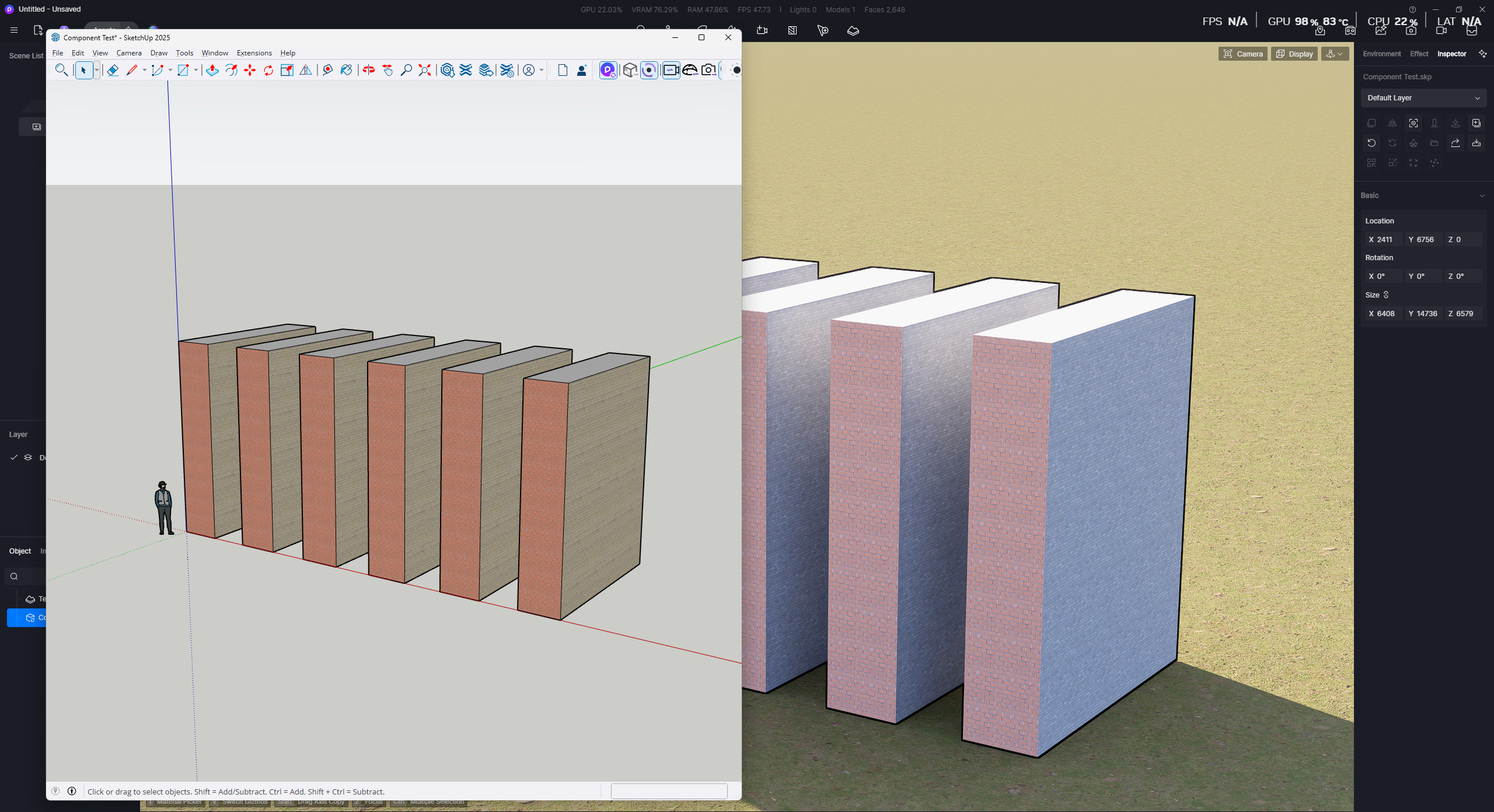

Hi @WB5
Sorry, but I don’t quite understand the issue. I tested it on my end, created a Component in SketchUp and changed its material in D5 Render.

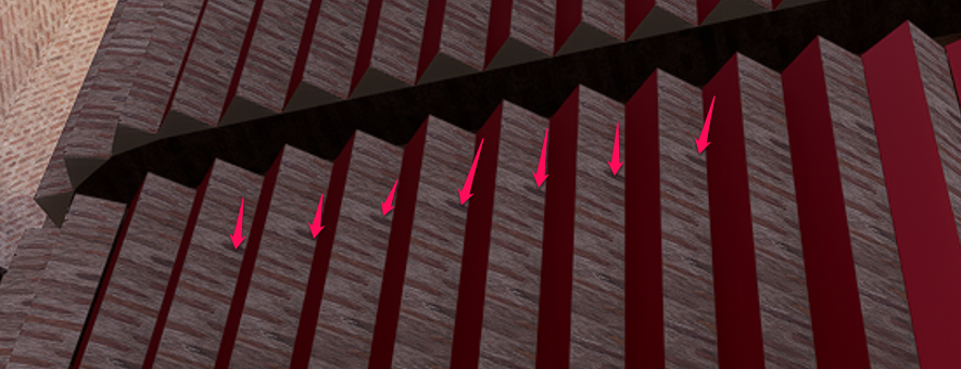

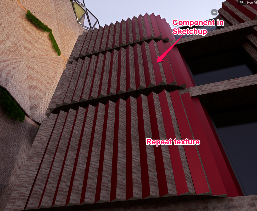

Hi Team - your example is correct. However when creating a component in Sk with a texture the texture will show a obvious repeat pattern. Copy of each component with the texture looks unreal. See pink arrows.
Can D5 allow to ignore the repeat pattern so the pattern of the brick looks more random across the pleated brick. If I explode the components(brick pleats) the textures show more random over all the pleats and the repeat pattern reduces (pending on the texture size)
But this means you cant use components in Sk with D5.
Lumion can do this. Lumion can ignore the component and the texture can spread over the geometry without being bound to the component. Hope I have explain it better?

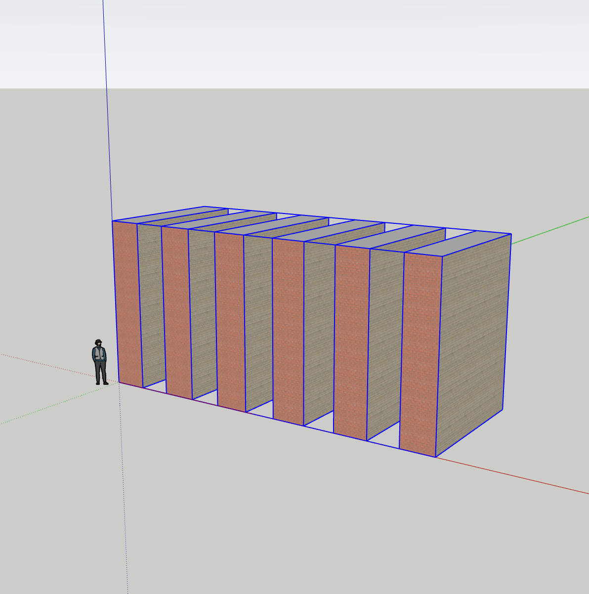

I ran into the same issue — the component texture is copied using the component’s local coordinates.
Suggestion for the D5 team to add such an option (I’ll try to explain it clearly):
In D5, when selecting a texture displayed on the model and replacing it with a texture from the D5 library, it would be useful if the texture could be applied using the D5 global coordinate system as a single continuous texture across all selected areas.
Currently there is only one option — the texture is applied according to the coordinate system defined in the model or component (marked as 1V in the image).
The goal would be to allow the texture to be displayed like in image 2V.
