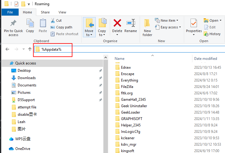

If it does persist, you might also want to try a complete Reinstallation of the plug-in:
