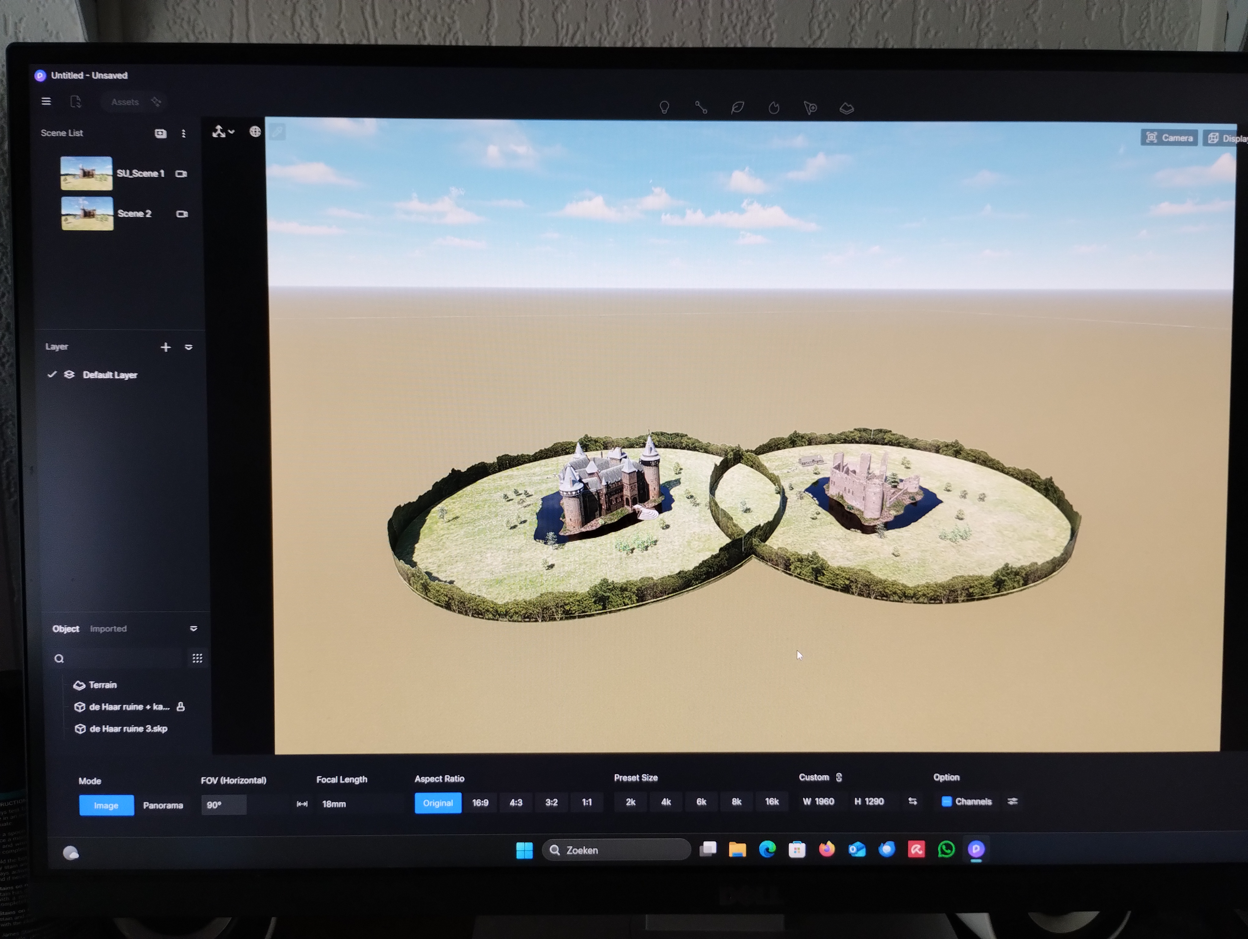

Want to put 3 imported sketchup files show in 3 different scenes and later make a video clip of the scenes. Can’t get them separated in a scene?

More simply explained. In Sketchup I have scene 1 with landscape and ruin and a scene 2 with landscape and castle. I can’t get these in separated scenes in D5 Render. Also not with different Sketchup files.
Just hide one skp file you dont want and update your scene, then do the same with the other one. Also, would be good to put it onto a separate layer. This way its easier to hide/unhide
Thanks. Just the right procedure.
