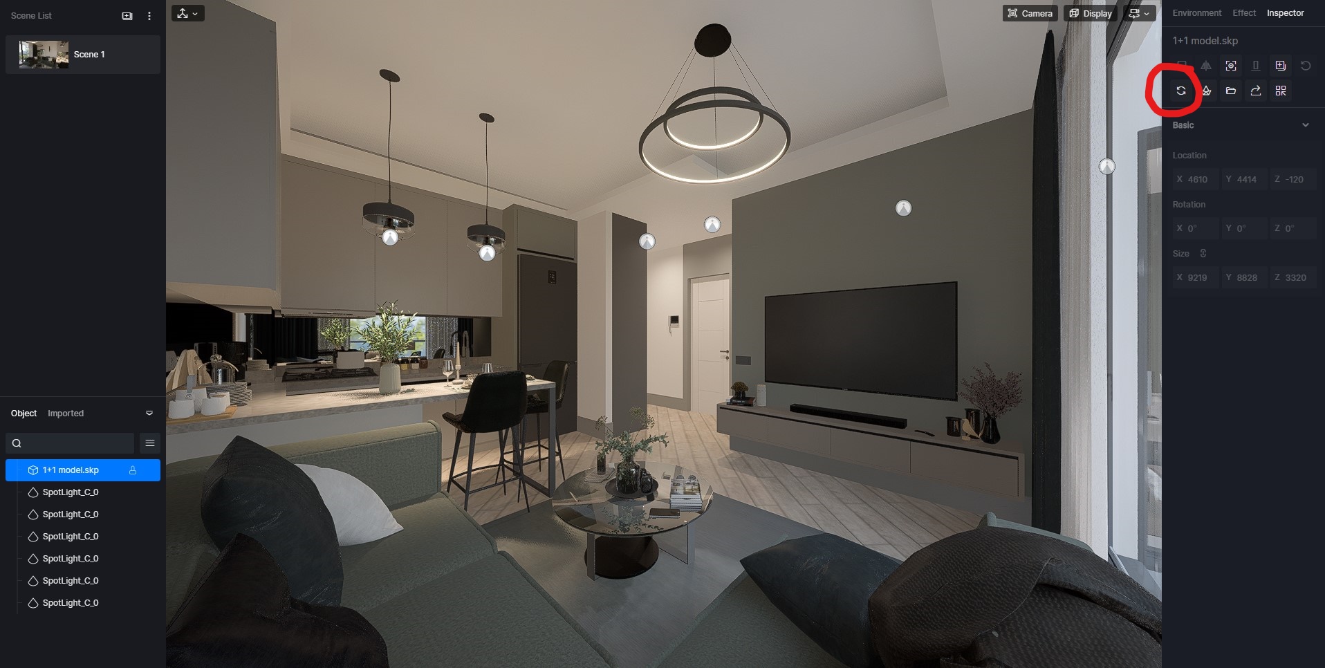

  • After clicking on the button to synchronize the Sketchup converter with D5, Sketchup crashes. when it comes to the 100% stage, sketchup turns itself off and generates an error report before it is transferred to D5. I don’t get any errors when I perform this operation on other sketchup files. In order to update my file in D5, I first save the sketchup file, and then I have to update it with the update file option in D5. And that’s delaying my job.
  • Synchronizing Sketchup to D5
  • Error report caused by sketchup crash
  • I can only update from this button for now.
