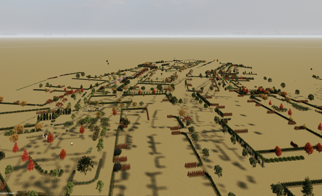

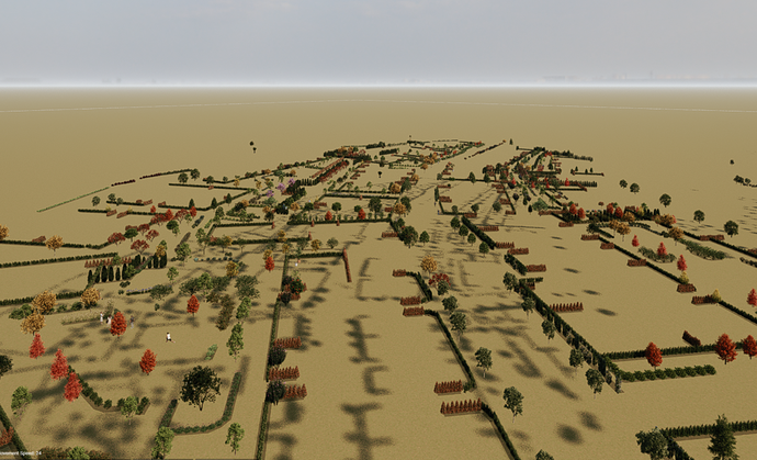

I had my SketchUp model in D5 Render, and they were working synchronized. Then I made an update to the model, and when I synchronized again, my buildings disappeared. How can I get my buildings back? I tried restarting both programs, but it didn’t work. The SKP version is 2023, and D5 is the latest version.
I apologize for the inconvenience. Were your SKP and D5 files stored in cloud storage? If so, we don’t recommend such a workflow yet. Please download them first to your local folder.
- After downloading them in your local directory, you may open your D5 File first then your SKP file, then proceed to enable the Live-sync plug-in.

Yes it does, but when i closed live sync and deleted live synced model then i imported skp file manually, the problem looks solved. Nevertheless, I still require live sync functionality.
Then, relinking the model via Live-sync still causes the main model to disappear after some time?
- Can you attach a video recording of your own process? We would like to review it.

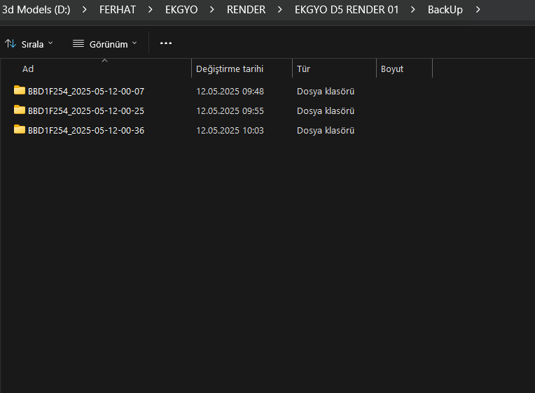

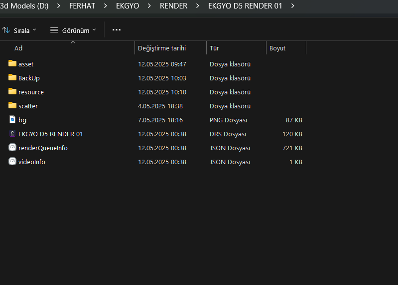

My file size is around 20 GB. I want to reduce it. If I delete the backup files shown in the screenshot, what will I lose?
Basically, you’ll lose the save points generated by the Auto-Save feature of D5 Render. I don’t recommend it since these back-ups may be helpful in the long run, especially when your file experiences some problems.

I recorded the live sync problem. I am using skp 2023 and d5 Render latest version.
Here is the video link: Unique Download Link | WeTransfer
This is the same issue that you experienced before, right?
Can you confirm which D5 Livesync Version you are currently using? The latest version is currently at Version 1.5.0.0017, Please send us a screenshot.
It seems that this particular issue stems from the SKP Model based on the “black screen” that you have experienced, please try to optimize or purge your SKP file.
Let us know of the results, if updating to the latest version of the plug-in or optimizing your file does not work, we may need to collect both files for testing.
