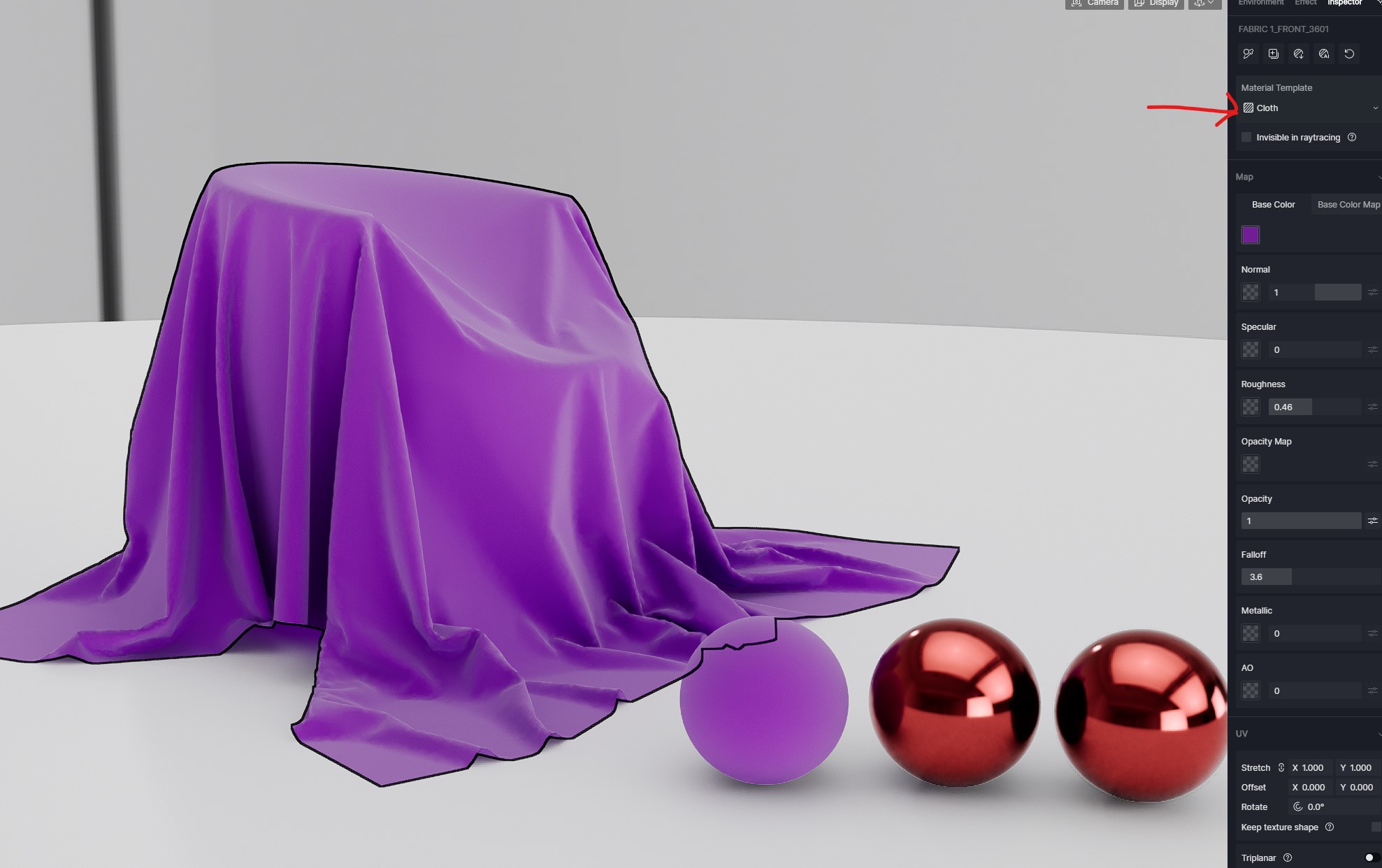

The Sheeln effect you can simulate it with the cloth material, but it is still not top effect. We have no possibility to control the color gradient. We can’t change the color. You can only control its power.
