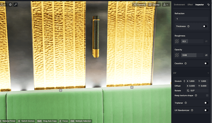

Im trying to use the semi transparent material to create a glass that will have a glow shine through from the inside but it just come out as a dark frosted glass even if I change the color to white and play with opacity and select “affected by light.” I do not want to just make it emissive.
Hi @klacy1102
Which 3d Modeling software did you use for this? Have you tried flipping its surface (If it is in sketchup)? You may send the file of this 3d Model only so we can test it on our end. Thanks.
- You may send it to support@d5techs.com and have it titled ‘Clov-Forum Semi Transparent Material Help’
It is sketchup and I reversed the face to the blue side and it worked. Tried that for other materials in the scene and its the same thing. Thanks for your help
