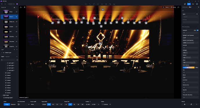

I’m a Sketchup + D5 Render user working on conference spaces designs
I feel like I don’t understand the materials well yet so need help with rendering screens in dark environments
- Textures blow out or get distorted/pixelated.
- Screens are too dark, too bright or too saturated, losing original graphics quality
- Struggling to make screens emit light naturally without overexposing the screen and scene.
Rendering plain colors looks better, but cleaning up in Photoshop is time-consuming
Render samples:
The original Graphics:

I’ve been tweaking settings, and the image is improving, but something still feels off. Maybe I’m pushing D5 too hard. Tried adding same image to Intensity Map and it helped with Image blowing up in the dark areas!
Base Color Map + Intensity Map
Photoshop still looks better when it comes to the preserving Graphic quality, but so much hassle with masking and editing
Desired result would be something similar to the following mockups:
*** For the Fill Light effect found a Temporary fix:
Added a rectangular light in front of the screen to fill the space, matching the screen’s color. Still, I wish I could make the screen itself emit light more naturally, especially since the graphics may vary in color.
No fill light render:
