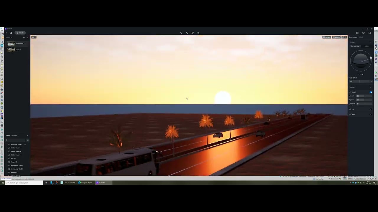

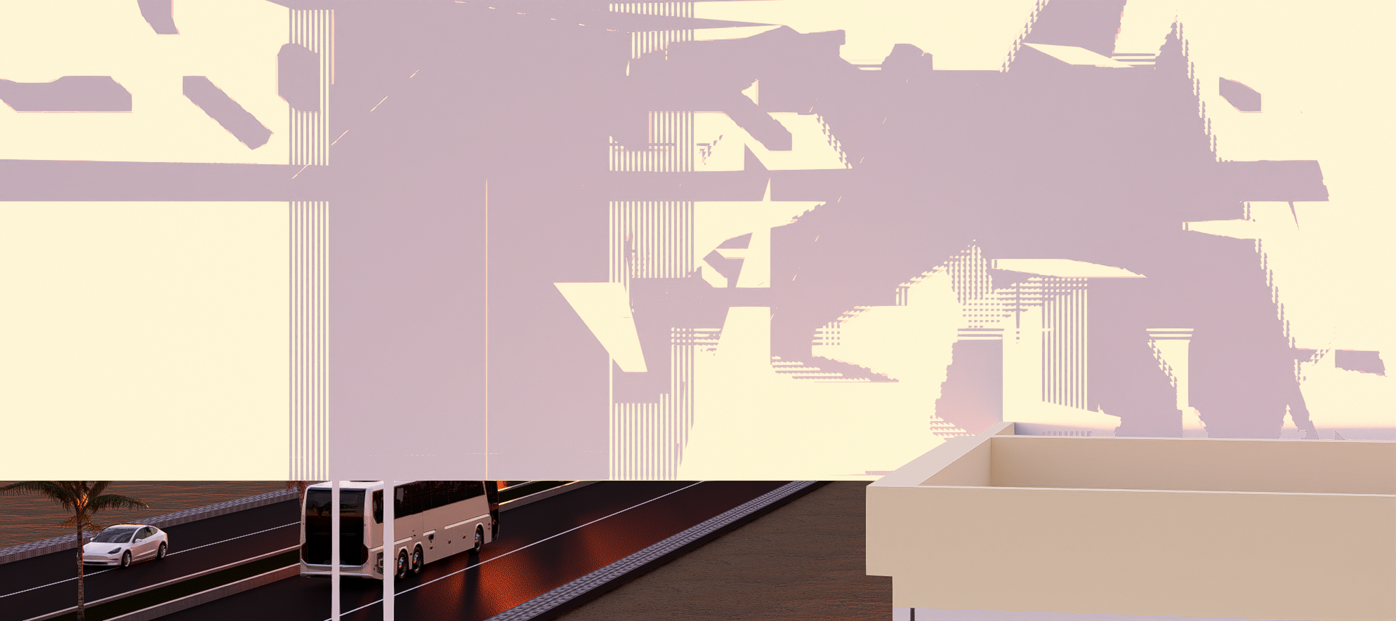

I updated the rtx 3080 video card driver. There is no object on the screen, no material, only an image. Any idea what the problem could be?
Hello, is it a model in the left list? I think the problem happens to only this scene file, right?
If yes, could you please compress the scene file folder then send it to support@d5techs.com or my email ziyin.zhu@d5techs.com? We may need check this file to find the issue cause. I guess the model is too far from the origin point in modeling software, maybe you can check it.
Right. Model is too far from the origin point. Solved. Thanks:blush:![]()
