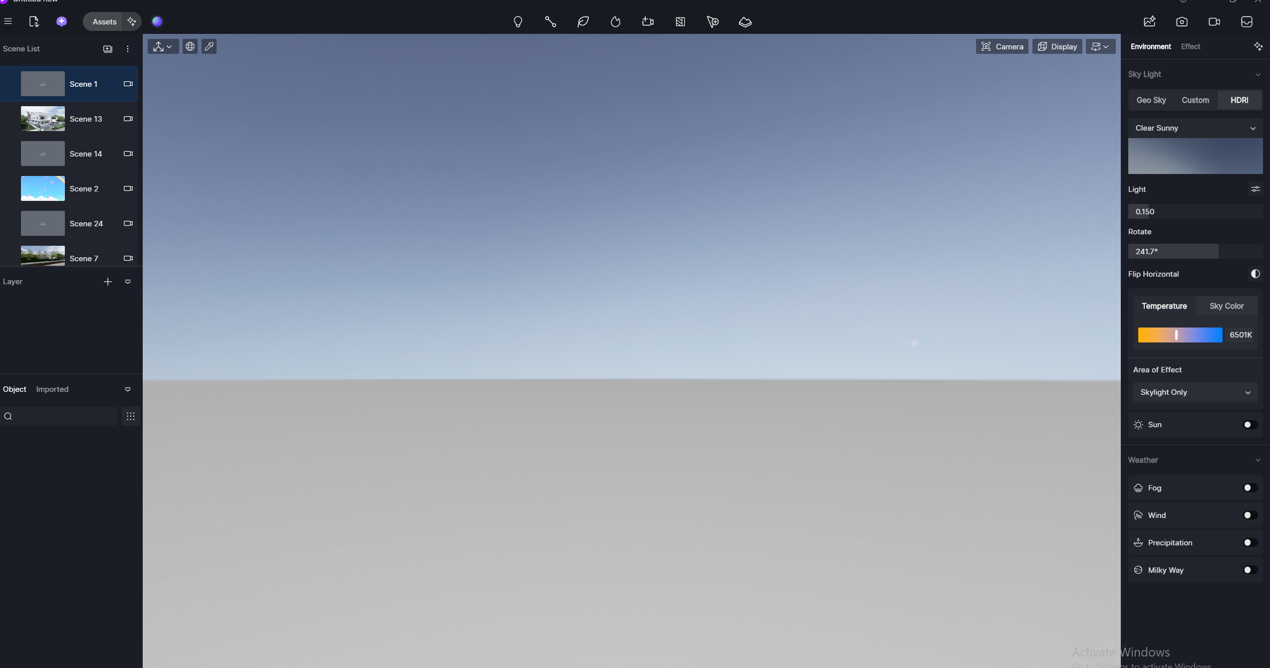

can i send mine too, i have a couple of projects with this issue
Hi @oyemadedavid
From what I can see so far, your object list appears empty, and some scenes seem corrupted or completely blank. Could you clarify a few things for us?
  • Was everything functioning normally before this issue started?
  • What steps did you take before these scenes became empty or corrupted?
  • I noticed that your scene numbers aren’t in order — did you delete or rename some of them?
  • Also, when you click on a scene that shows a display picture/preview, does your model appear there?
