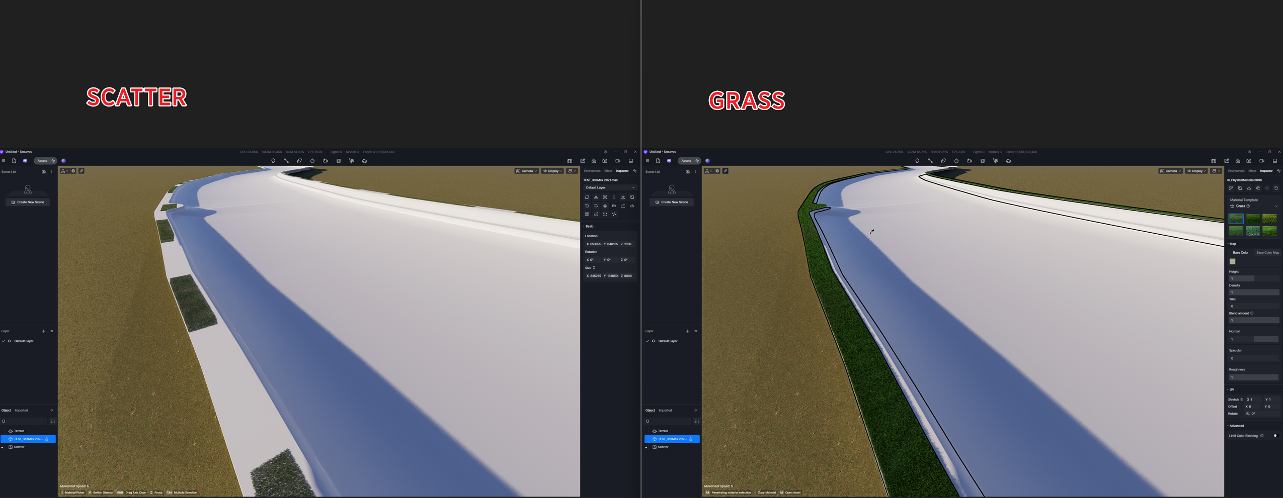

  1. Apply UVW map in 3ds Max (box 300030003000)
  2. Export fbx file
  3. When applying scatter after importing into D5 render 3.01, a scatter error occurs as shown in the attached image.

  1. I have used D5 and worked on 5 projects. The same issue occurs in all of them.
  2. The same symptoms persist even when changing the UVW map in 3ds Max, and there are no hidden faces.
  3. The same symptoms occur in 3ds Max Live Sync. I even tested the UVW map in Live Sync.
  4. As shown in the attached image, scatter marks are applied in a checkerboard pattern, so I always have to fill them in with a brush to finish the job.
    I would like the scatter marks to be applied to the entire object.
    It is very inconvenient.

We’ve confirmed that this follows the same logic as Smolak’s other forum post.
  • This issue arises because the scattered piece is both wide and narrow. The current processing logic makes this the Scatter Highlights very large, and even when the Scatter Quality is set to the maximum
Hi @Clov, please prioritize because this is major issue inside major D5 feature.
Also you are little wrong about Scatter Quality - lowering this value to 50% can help to resolve this problem. It looks that there is internal limitation of overall instances. Increasing quality with increasing amount of instances can trigger this issue. And this is related to Cluster Size parameter only.
