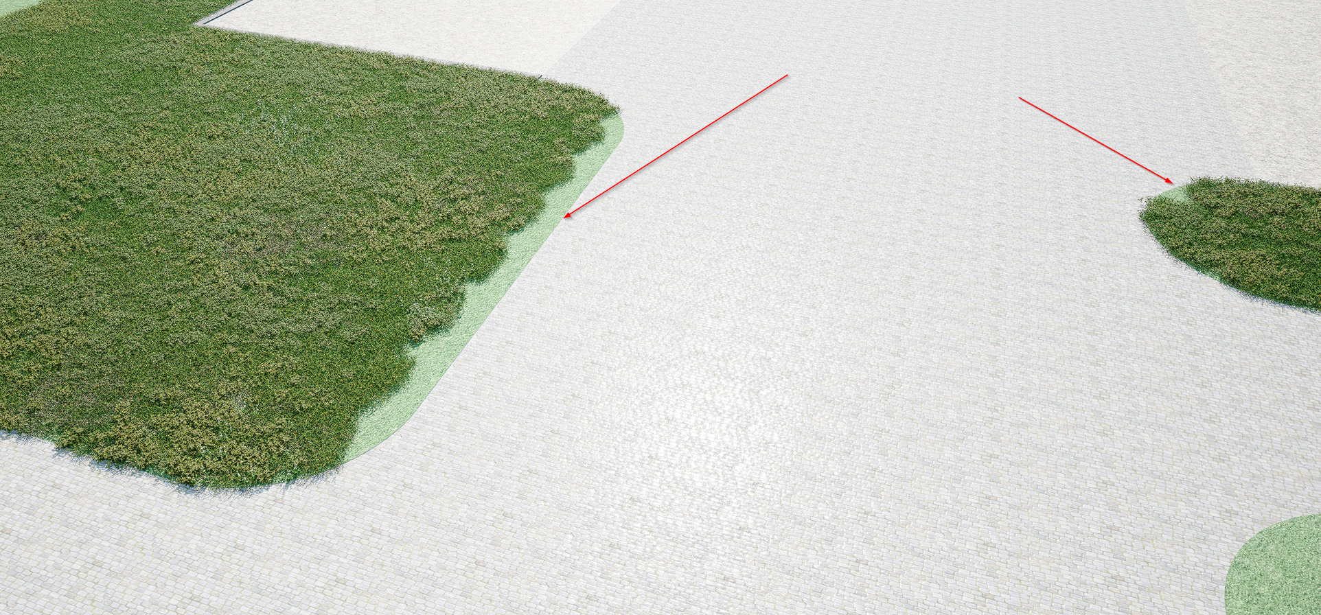

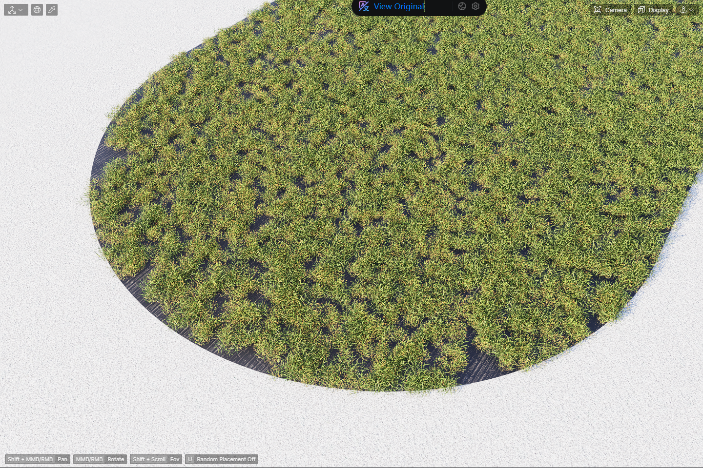

Is there a setting that i am missing why my scatter is not complete filling my materail?
Hello, have you checked in the software you modeled that the texture does not overlap with another,
or that it is a section of the texture with its face inverted?
Regards

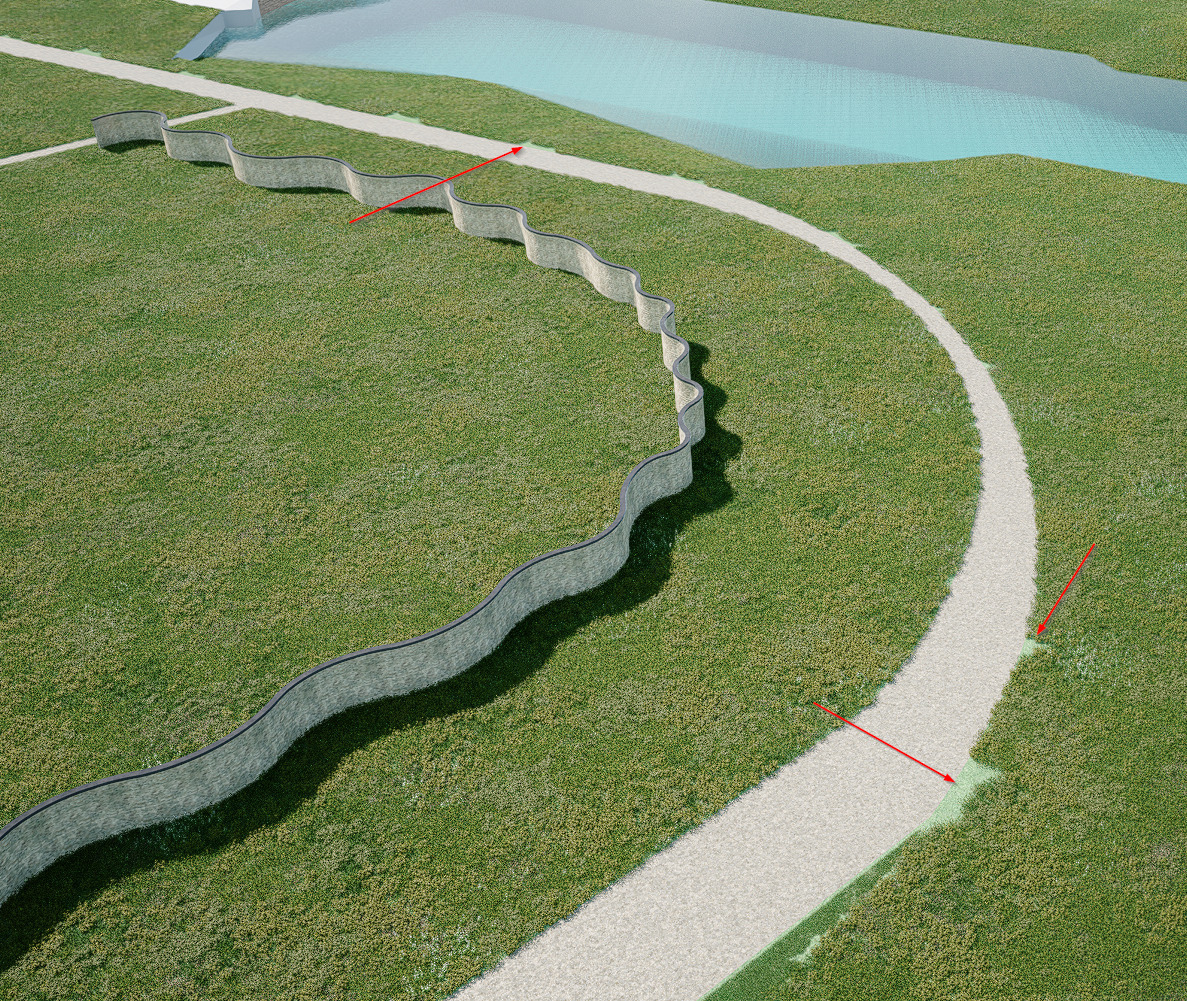

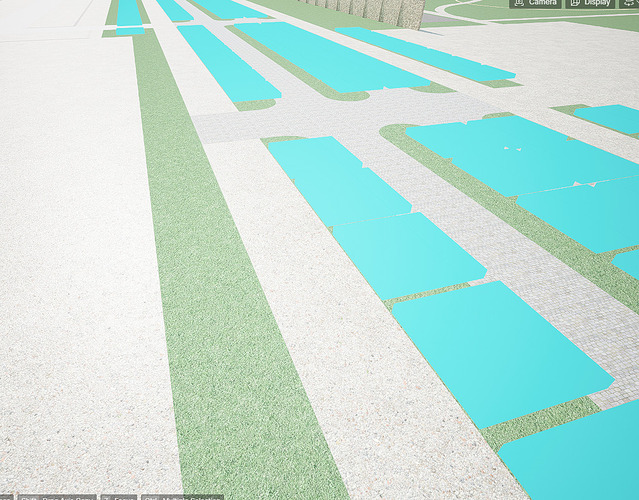

Please note that the issue was mainly caused by the grass scatter being quite small. I will send it as fast as possible. @Clov this is the castle project.

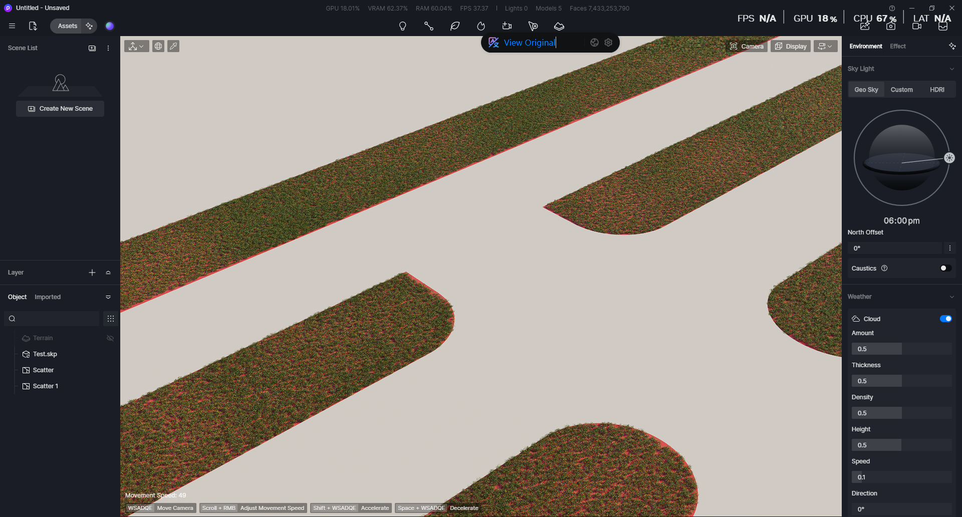

i will send the file now. i did improve some modelling stuff. but still some stuff where grass is not filled.
i did found some solution on some area’s to make the scatter area smaller in my model.
instead of a big one. make 5 smaller ones.
that did work on some location.
but not on this area.

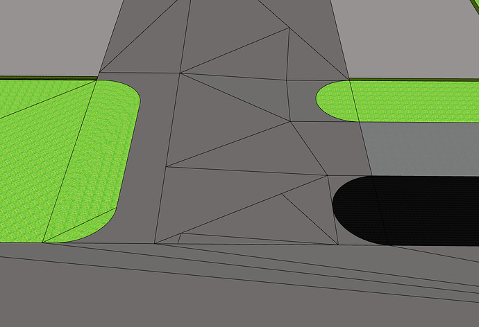

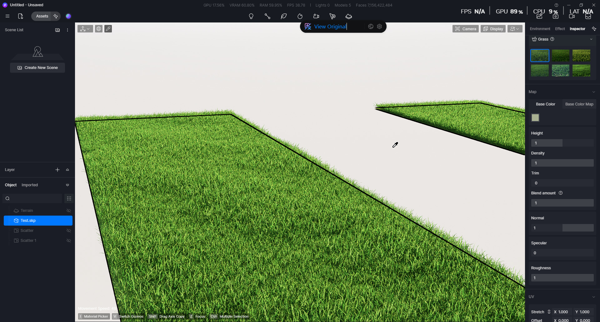

I did several tests on your file, I managed to separate the portion of this material and placed it on an empty SKP File.
We will be further investigating this issue, to confirm if this is a bug or a limitation of our Scatter Tool.
Since you want to place grass on this specific surface and considering how this surface is narrow and have a precise edge, I think it would be best to use the Grass Material Template.
