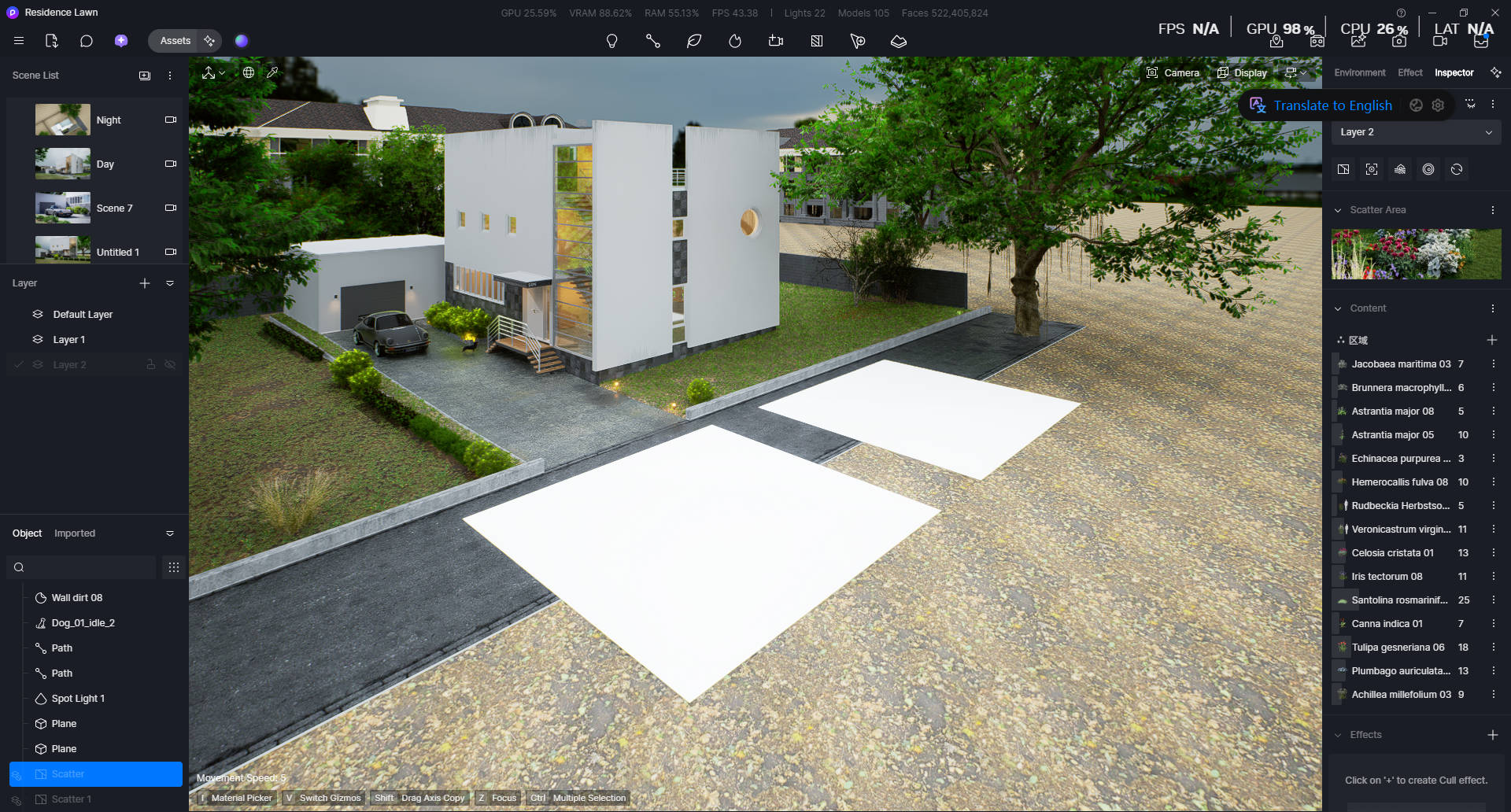

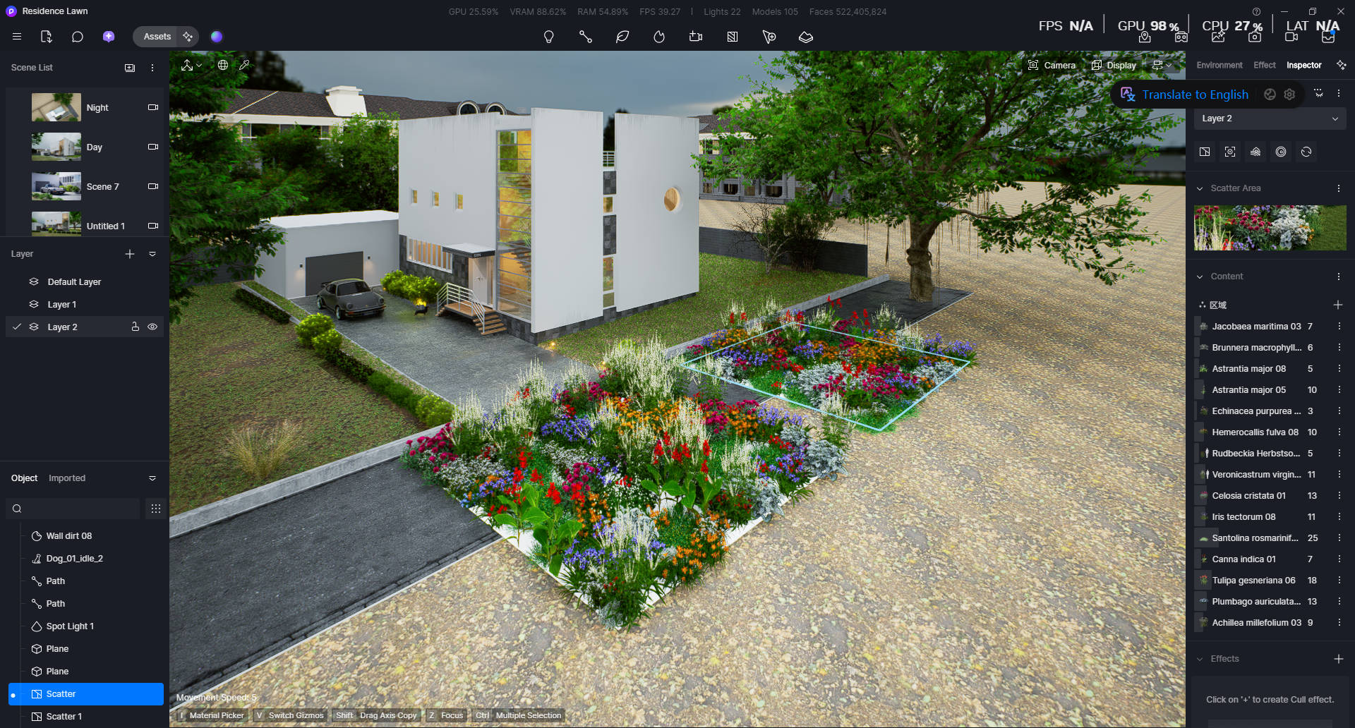

The other problem I am having with Scatter is when I create a layer for my Scatter Plants.
When I turn the layer off to work with the rest of my model and then turn it back on the Scatters I have created are gone. This is a big problem.
Thanks
Hi @3Dquin
The issue regarding Flower Garden Combo 06 displaying the same composition with Flower Garden Combo 07 is currently being repaired.
- As for your other problem, I can’t seem to replicate it on my end. Im not sure if I’m missing some steps, but basically I placed 2 Scatters in a layer, then proceeded to hide the layer > Then, unhiding, scatter does not “regenerate” nor will it disappear. Please share a video recording of this issue so we can check if we can replicate it or not.
