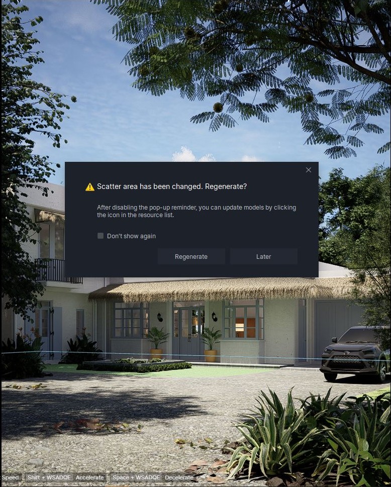

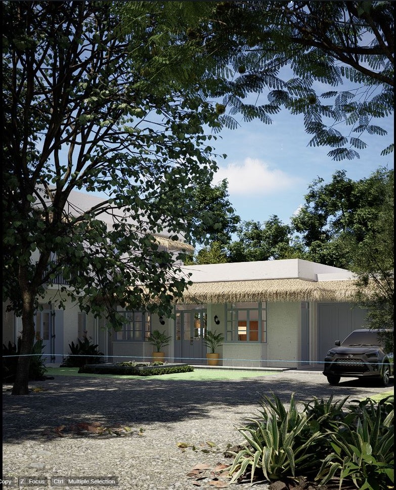

Regarding the scatter issue, basically what happens is:
I configure my scatter area, detach unwanted assets from the scatter for the scene I am building. I didn’t want the tree from the scatter blocking my view of the house. (Image 1 is the view I want with all detachments done).
And then, I save my file and close D5. When I reopen my D5 file, I get prompted to regenerate all my scatter areas. (Image 2)
And doing so, all my configured placements/detachments are back to their default location. So I have to remove everything again every time I reopen my file. This is troublesome as I work on different projects and reconfiguring scatter areas every time for different views is simply just bad.

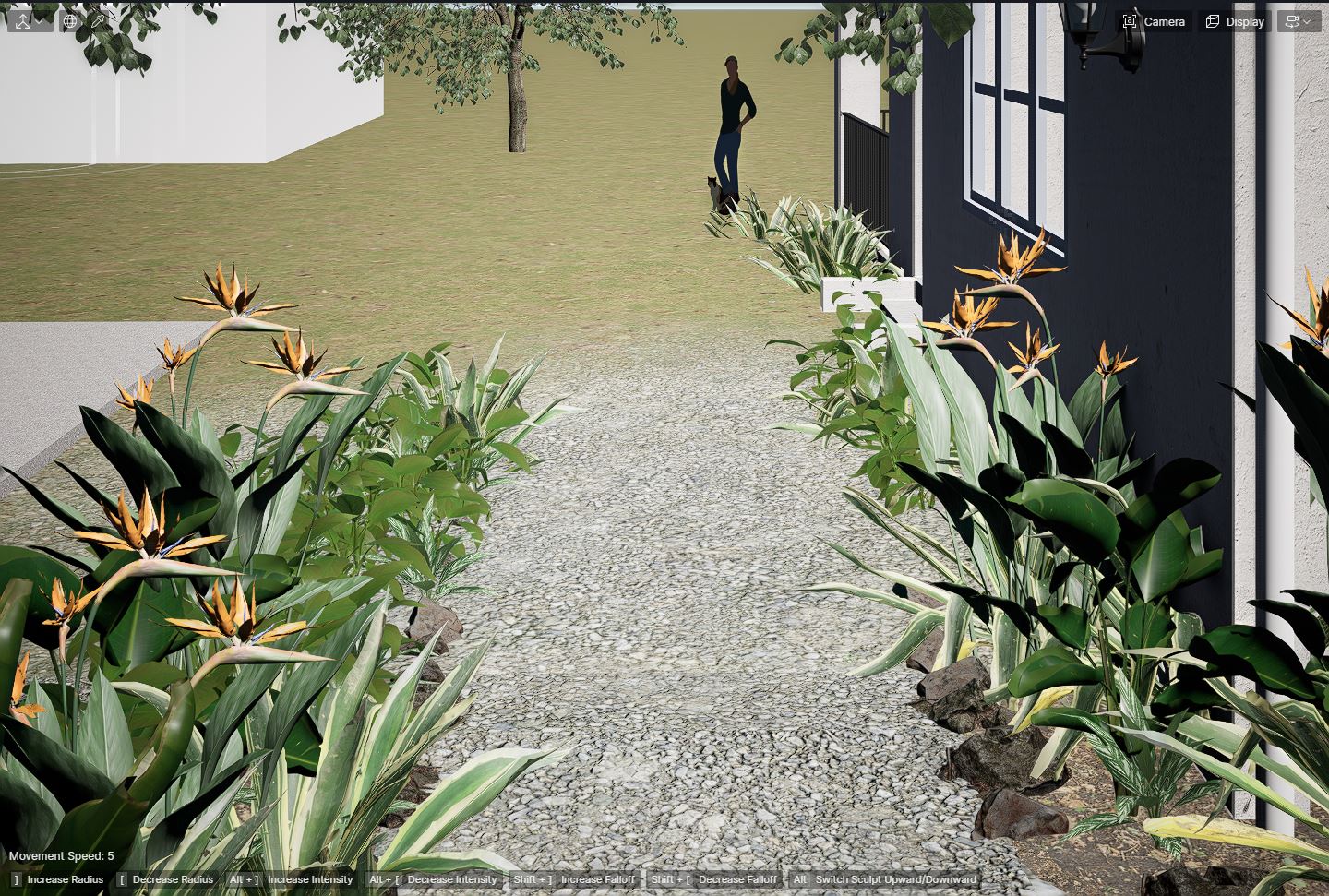

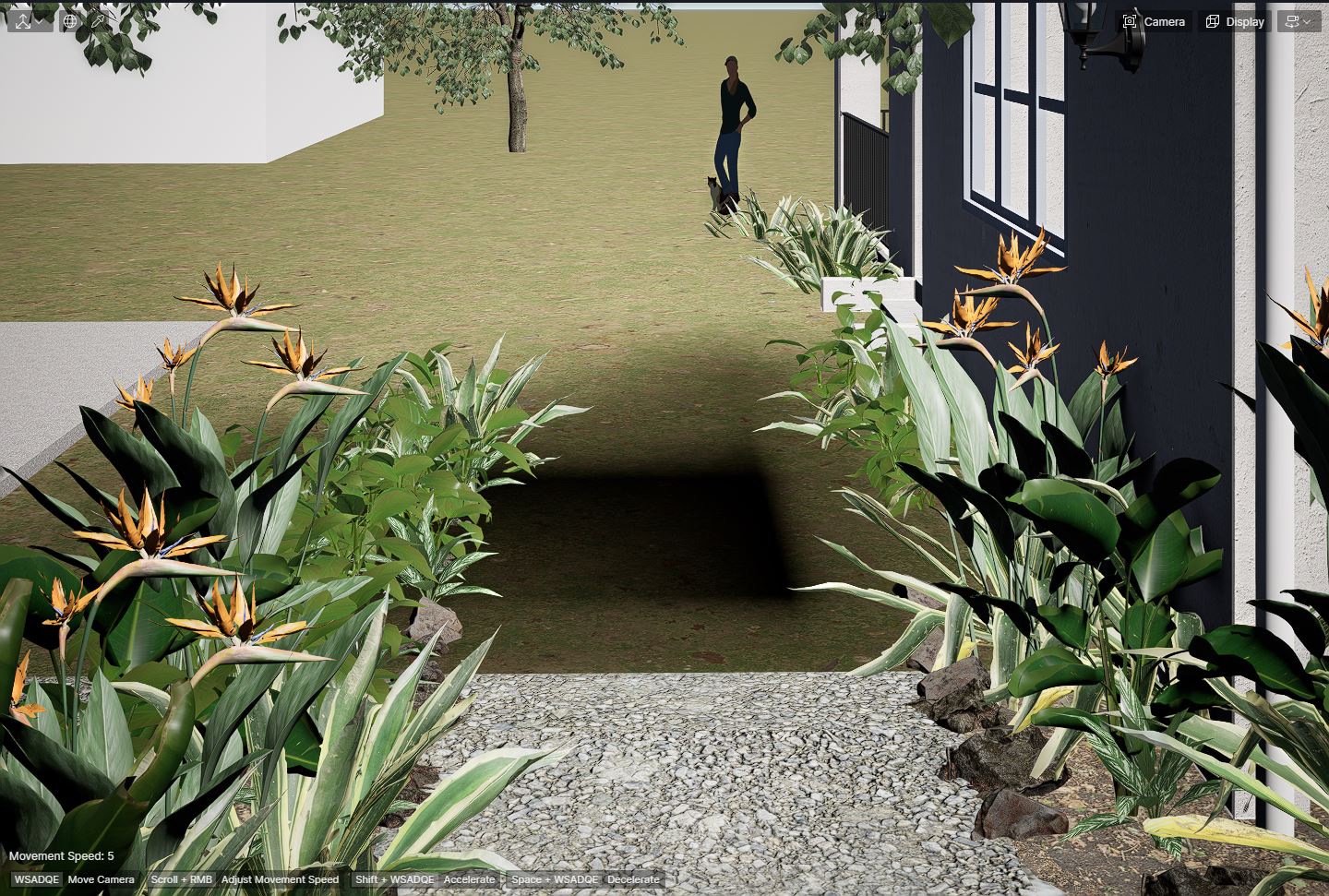

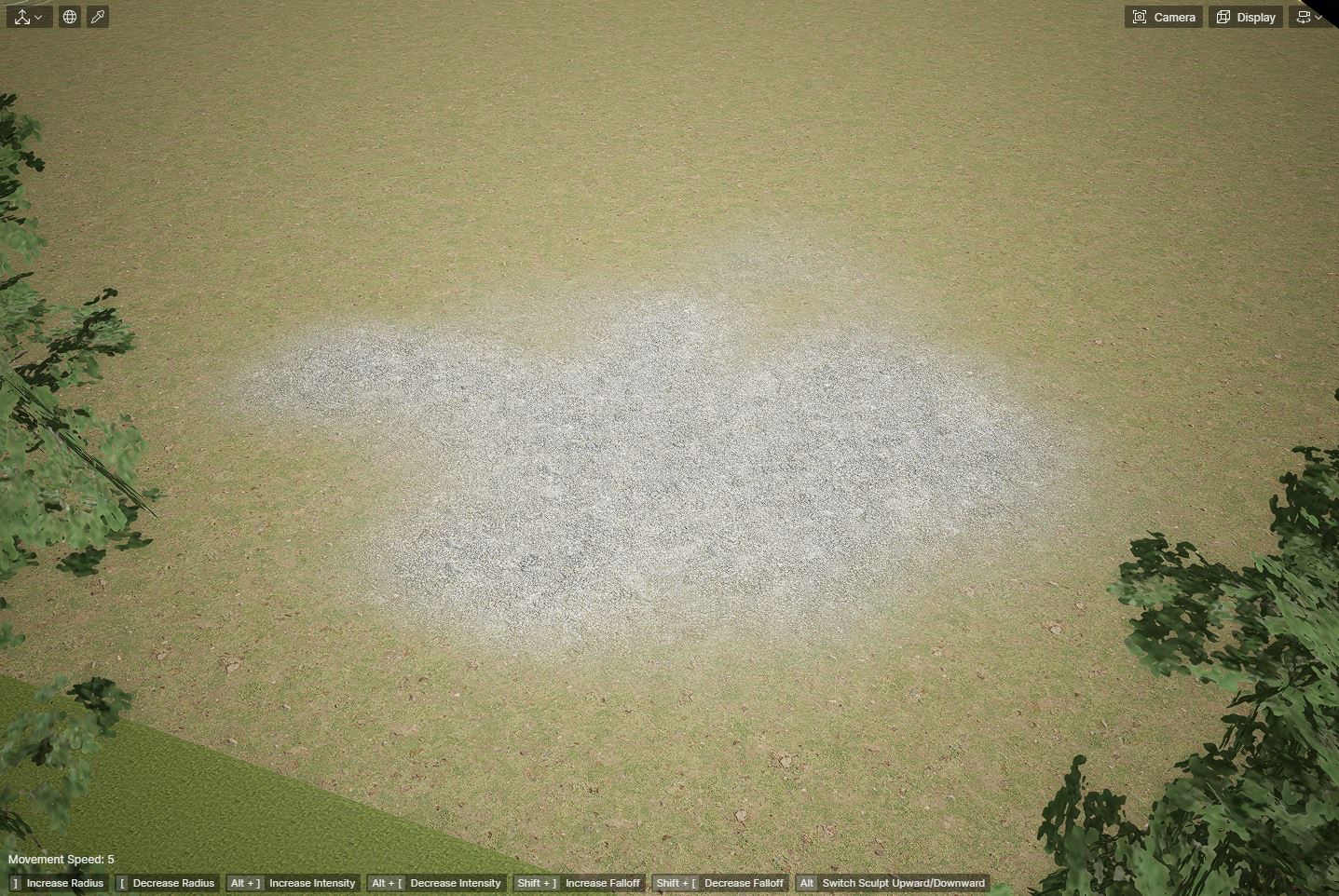

Hi there I apologize for the incovenience. You may send your files in this google drive folder : Upload Here - Google Drive, please include the file that has now the terrain issue since I also tried it on my end and the issue was not evident. Thank you so much
The file has been uploaded and compressed to a zip file. The Terrain issue was observed in the same project. Please tell me if you have download the file! I might need to remove it before the year ends.
I hope you can look into the issue I encountered. Thank you!
