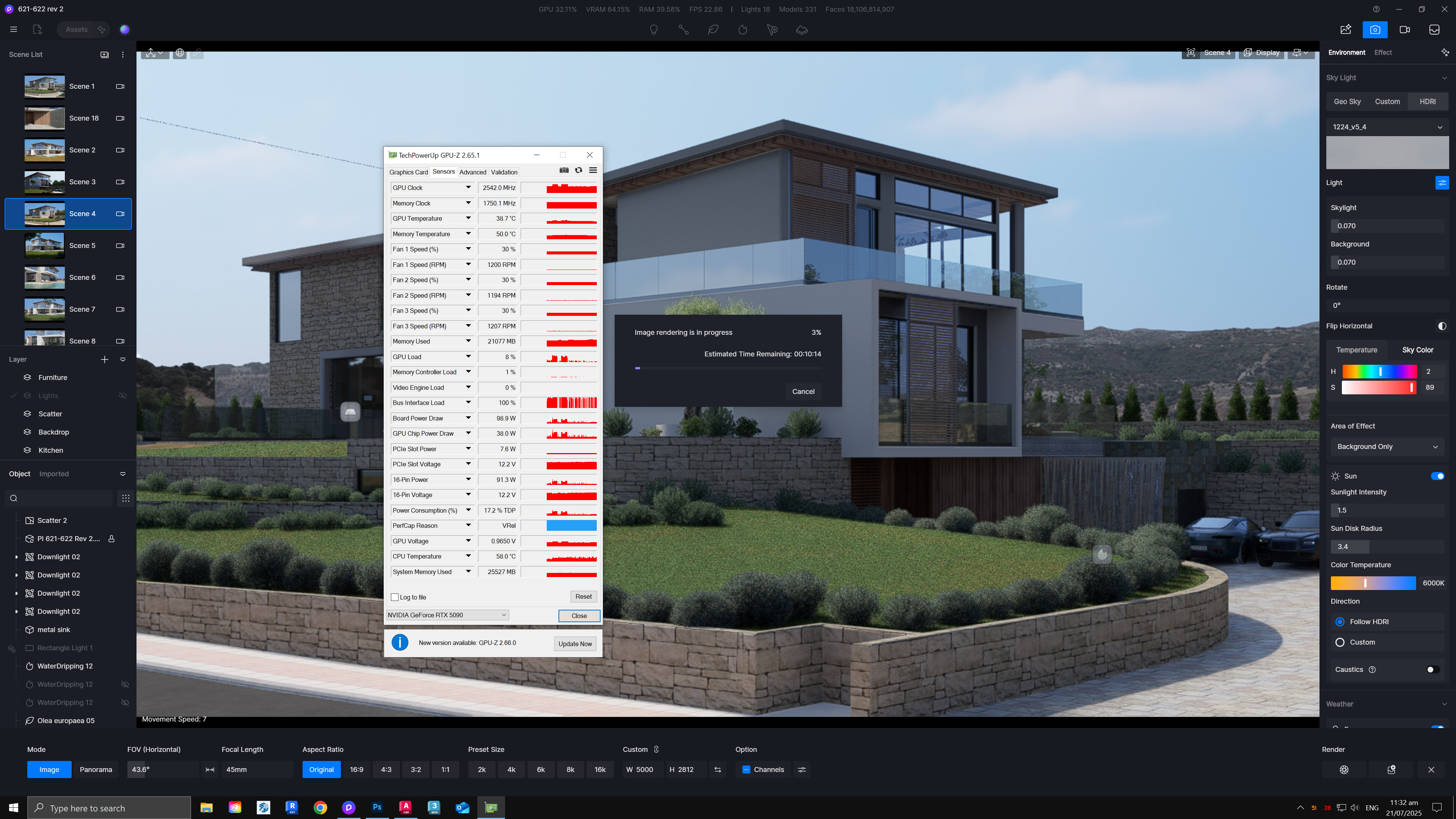

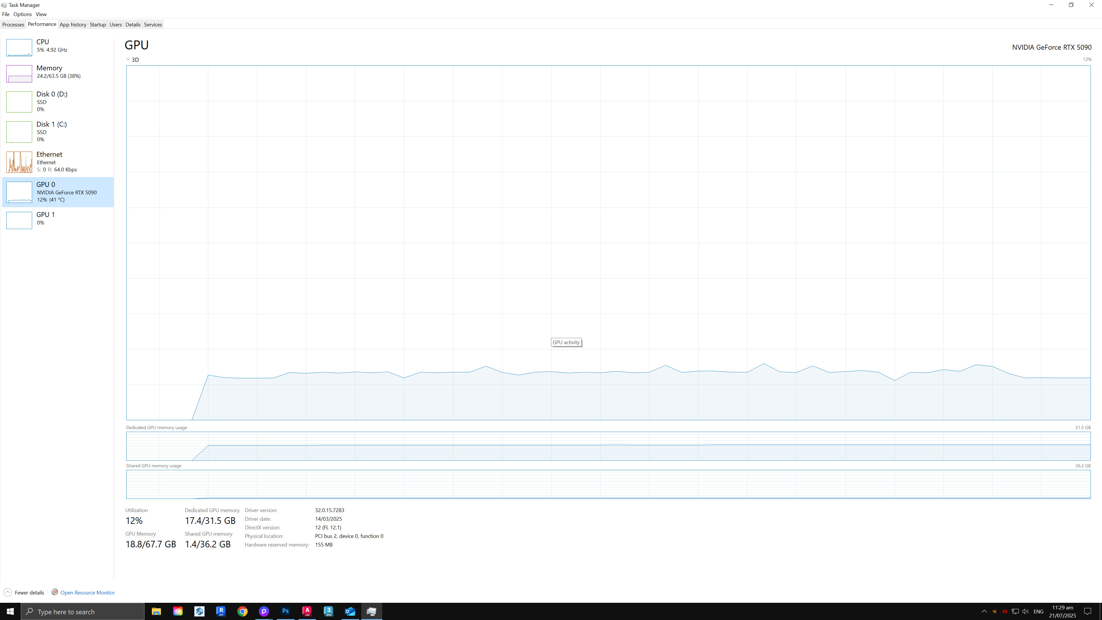

Hey, every time I use a grass scatter preset D5 does not use more than 1-60% gpu during render. Extremely slow rendering times. Many scenarios so not tied to an imported model.
i9 285k, RTX5090, 64gb ddr 5 6800mhz ram, Win 10. Latest D5 Pro version.

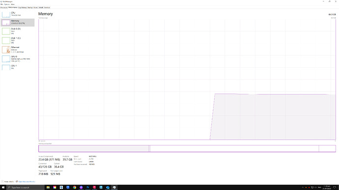

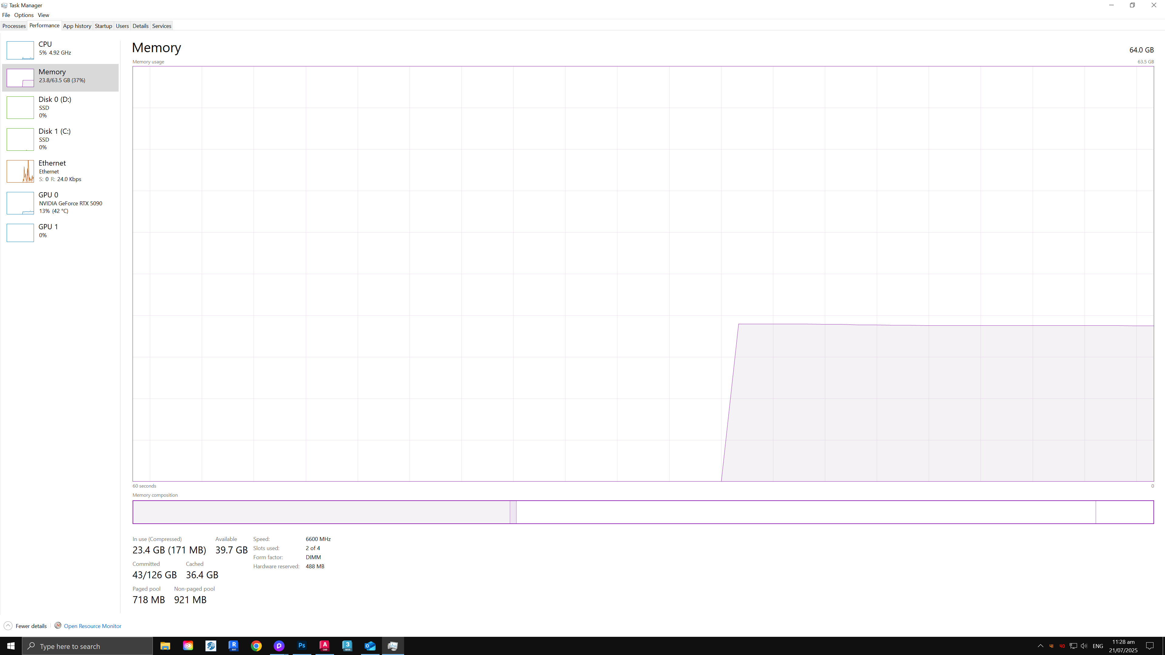

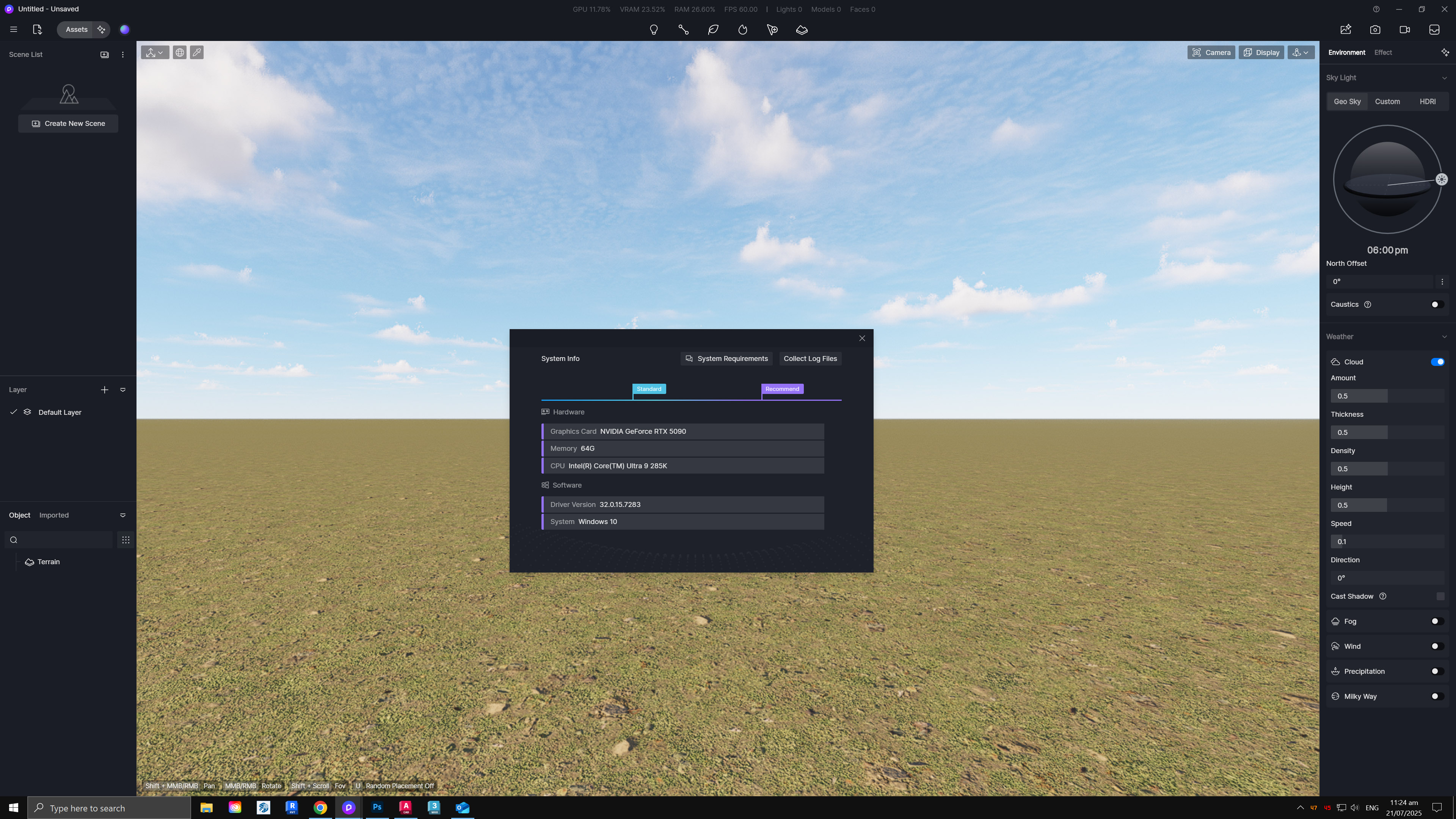

Please also share to us the following images:
- System Info
- VRAM - Please open your D5 File and use scatter while checking this portion
- Memory Speed

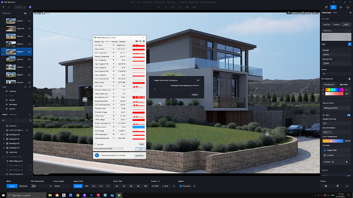

Open my working file today. Materials like glass are dark like mirror and I am unable to select any of the items (furniture) in the scene.

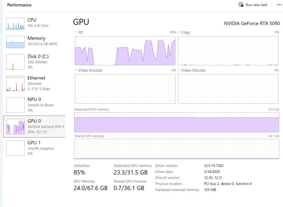

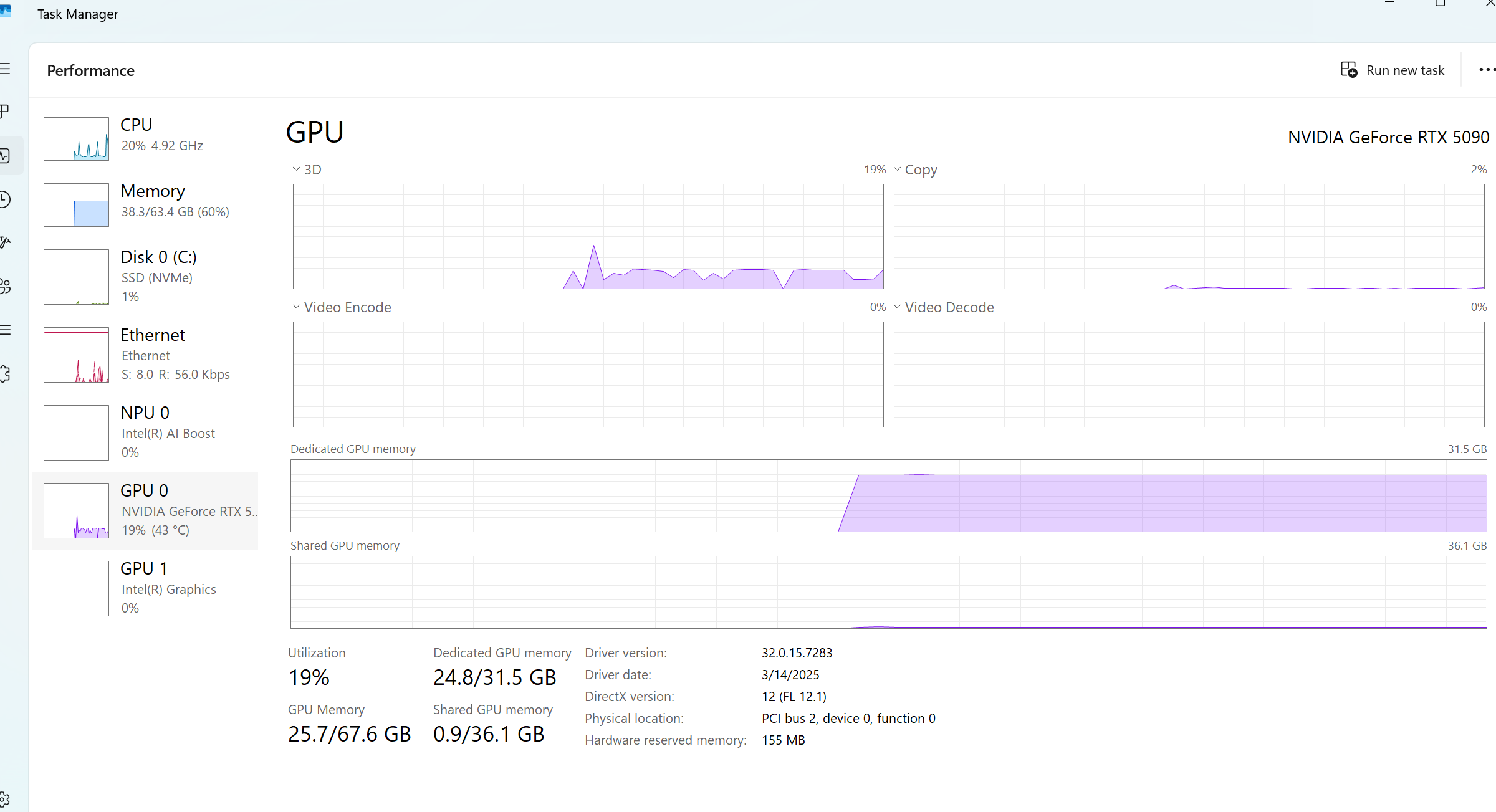

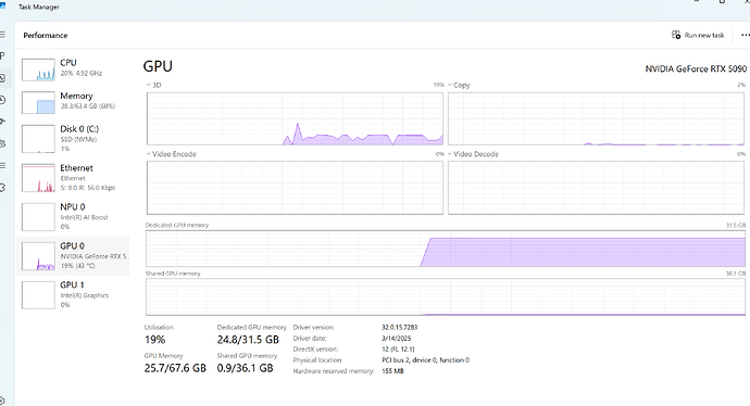

Scatter causes issues with 2.10 as well with RTX 5090. With scatter on, each scene would take about minutes to render, and GPU utilization stays very low at around 10%-20%, or less.
Scatter (grass) turned off, now it takes less than a minute to render a scene. GPU utilization also goes up much higher at around 80% at times.
Low GPU utilization with scatter on, and slow render
High GPU utilization with scatter off, and fast render

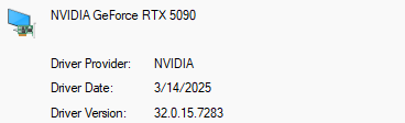

We’ve checked your log files, and we recommend trying to revert to the previous version 572.47 or perhaps 572.83.
To answer your question:
- There were no reports on this one aside from this forum post. We also have a 5090 device and tried to replicate it on our end, but were unable to do so. We’re running the previous stable version of NVIDIA Drivers too.
Already on 572.83. I don’t understand what you mean no other reports. Already 2 on this post. So no bug? D5 unable to fully use RTX5090?
