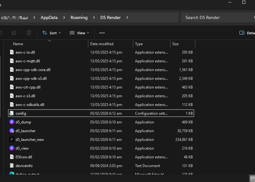

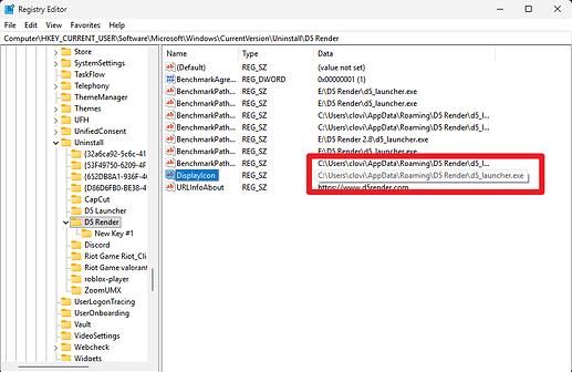

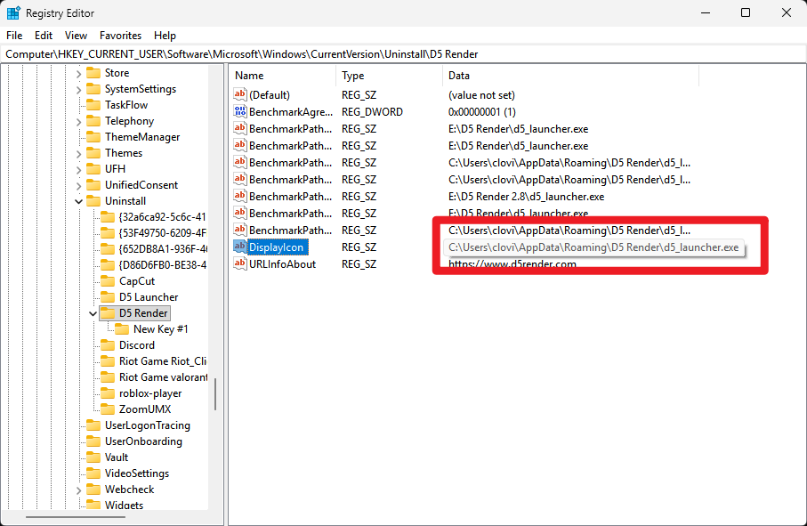

It might be that the plugin is reading D5 Render incorrectly. After D5 is installed, it writes a path in the registry at

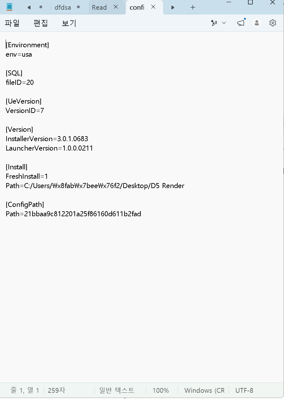

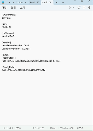

이렇게 잘 되어 있습니다
그래도 되질 않습니다
