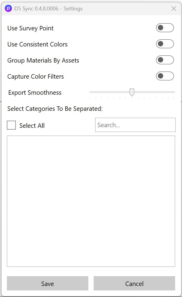

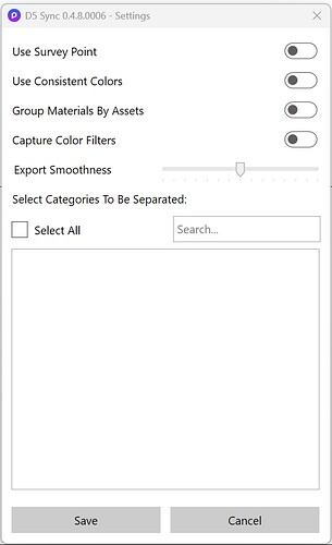

  • What’s your Livesync Version? Can you send us a screenshot?

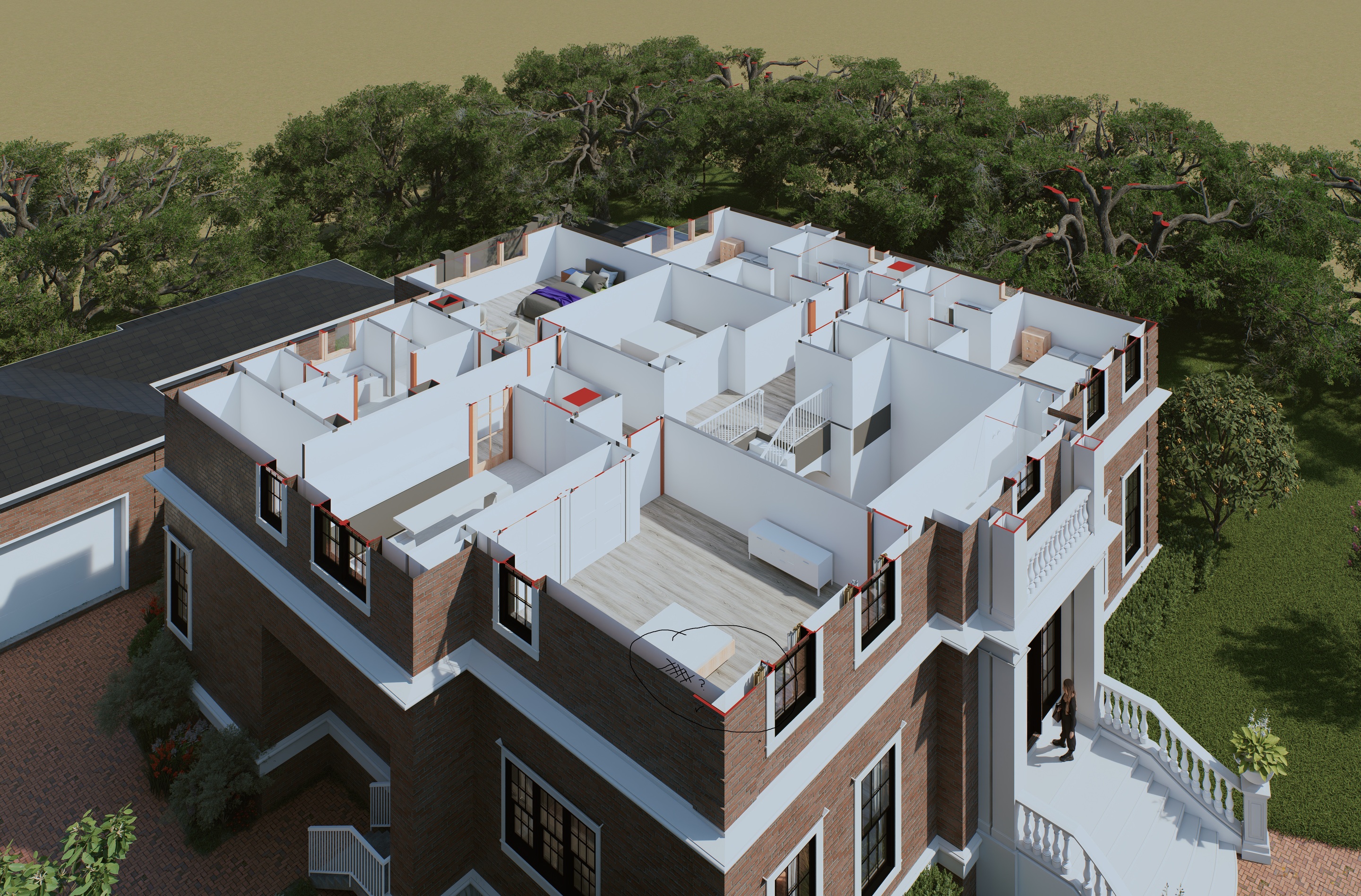

Not exactly sure why but it seems to be working now. Maybe it needed a system reboot. Here are my settings for D5 Sync. But now I have a new question-- why are only some elements adopting the color fill cut but my Revit walls are not?? I’ll add that screen shot here as well.

Please check the structure of the Revit walls that are currently displaying without fills in the section view.
Revit allows the definition of layered walls, where materials are added to the exterior and interior faces of the primary Structural Core.
  • We need to determine if the walls in question are constructed this way, for example, a structure consisting of a core and two other exterior/interior material layers, potentially including air gaps.
The fundamental rule for the Section Tool in D5 is that it only displays a fill pattern when it cuts through a solid material layer that possesses a defined thickness.
  • If the exterior or interior wall layers have zero or negligible thickness (or are primarily air gaps), it is expected for the fill to not appear in the section view, as the cut is essentially passing through a void or a boundary, not a substantial solid.
