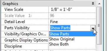

Hi deniel, thanks for posting. To confirm, the problem happens only to the ‘parts’ of this revit file, right? For other files without ‘parts’, the converter works fine?
Also, please let us know on this panel, what option of Parts Visibility did you select.
We will test and keep you updated here, thanks~
Thanks for your reply, Oliver! Very much appreciated
I had the properties set to ‘show both’ - when set to Show Parts it works perfectly.
Thanks again ![]()
Hello, you are welcome. Our dev team will look into this for the next version and make it consistent, so there will be no need to change that option any more.
