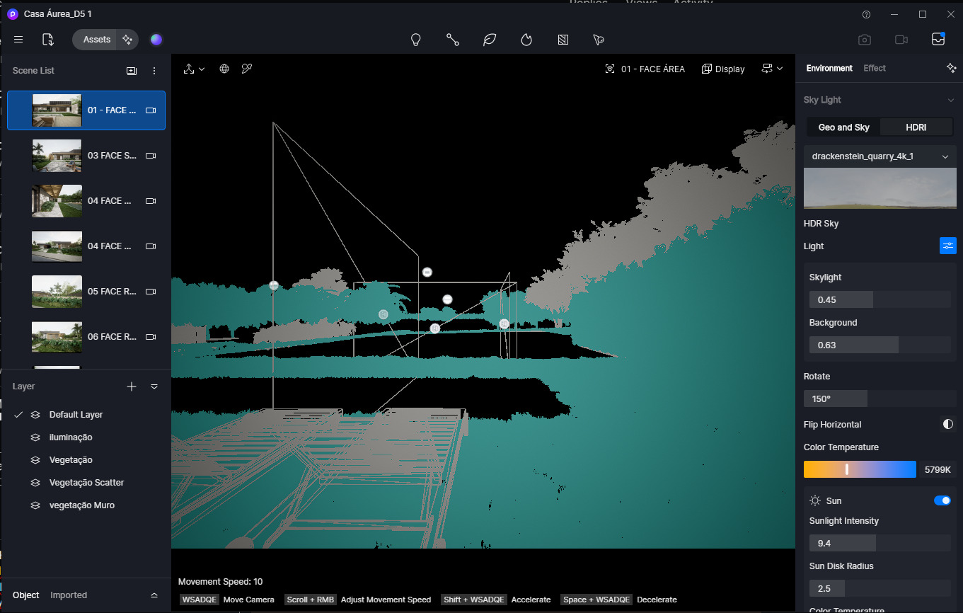

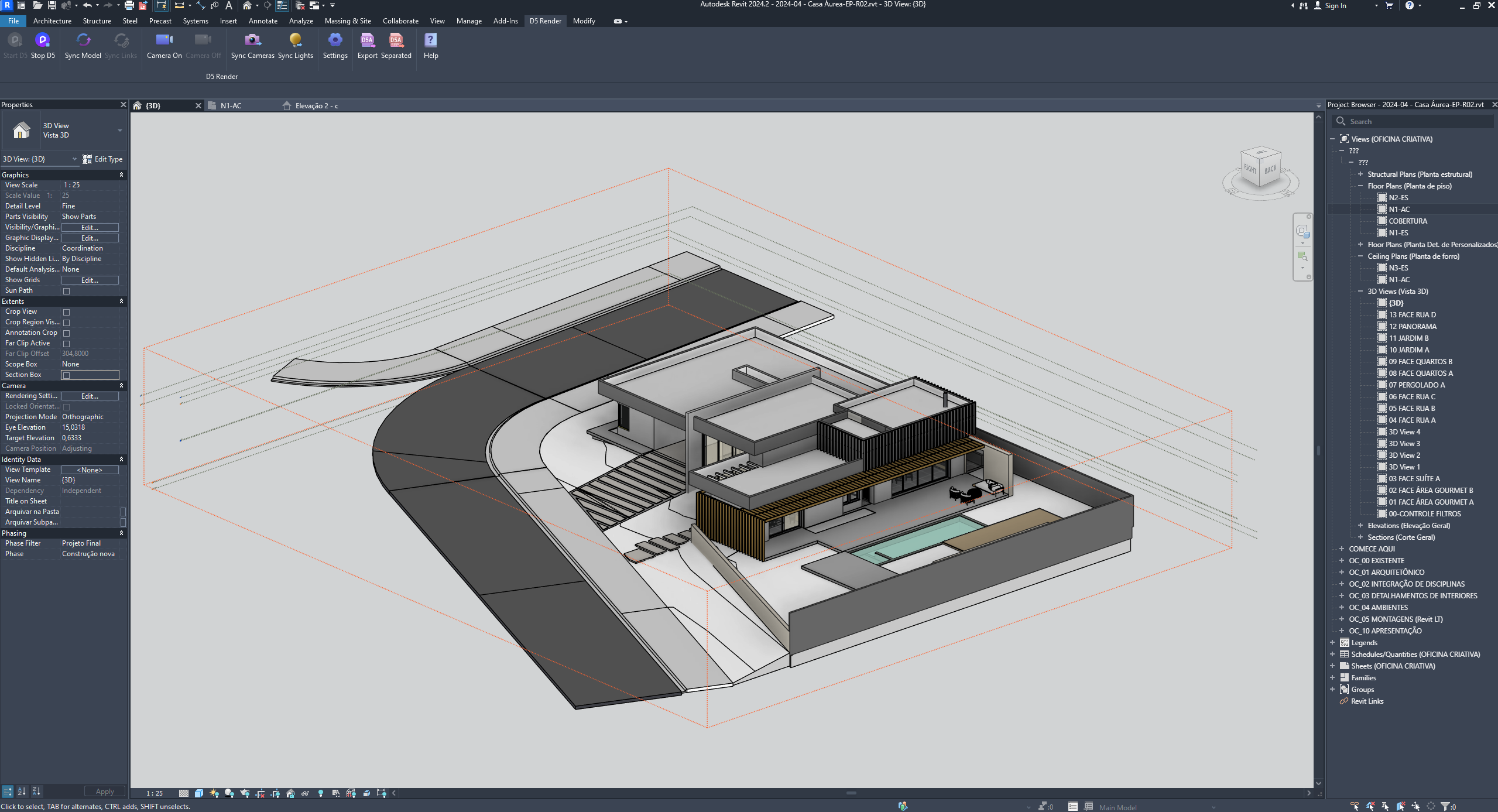

I loaded a new Revit file into a D5 file I was already working on. When asked if I wanted to create a new file ou replace and relink the model I’ve choosen Replace and relink, but the new new file just does not appear ,only A full gray screen. Even is a set to wireframe mode, is like there is nothing in th model. like if the other file was changed for nothing.
What am I doing wrong ? I can substitute the files ? like the version 01 of my project for the version 02, but keep the vegetation, scatters and assets I already placed ?

Hello! Thank you for the document. We checked your file and found a size anomaly in the revit file in the scene. Can you please tell us which version of the plugin you used to sync the model before?
I suggest you to delete the revit model in the scene and re-sync it.

We found that the replaced model was in a extremely small scale , still don’t know why it happened when we replaced it. the models placed in D5 stayed the real scale, and the house itself came very small , unable to see it of even zoom-in enough so we can se it.
I ,instead of replacing the model, created a new link of the same revit model inside of it and worked, but with cost os losing some vegetation.
