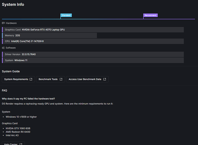

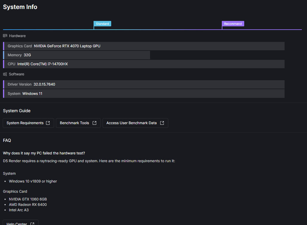

System info below:

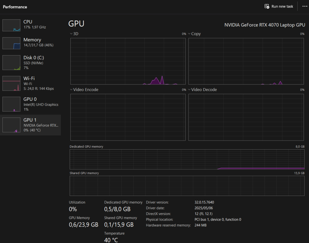

VRAM below:

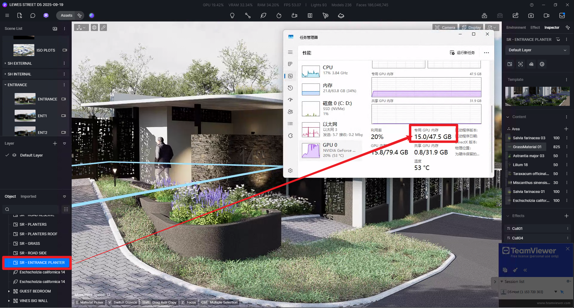

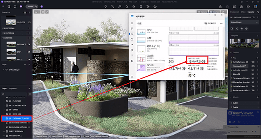

I’m able to open your file and regenerate the Scatter SR - Entrance Planter. I have also checked the VRAM Consumption, and it’s consuming 15 GB, which is more than the VRAM of your device.
  • Please try to access the file version history of your file and see if you can open and click the specific scatter area without crashing.
    version history
  • If it still does not work, please refer to my pm, I have a detailed explanation of deleting the f2 folder.

I want to find out why the VRAM usage is so high. Do I have too much planting?
Its just strange that some of the bigger scatter areas can be regenerated but not this smaller entrance planter one…
Also what would happen if I do delete the F2 folder as you mentioned in the PM.
Is there no way for me to delete the scatter area without opening the file?
I would like to request that there be some type of file editor where you can delete elements / scatter areas without opening the file, in order to work around these types of issues.
Thanks so much!
Shaun
Hi @shaunwillemse1411
High VRAM Usage may be caused by the following:
  • Assets: Generally, assets that are highly defined and have a great quantity (e.g. scatter) are usually the culprit.
  • Other environmental settings also play a role (e.g Path Tracing, Fog, Volume Light)
  • Please also check if other software is in use while D5 is running.
Deleting the f2 folder will cause all of your assets to lose their physical appearance temporarily; basically, it will look like white squares with icons. It can easily be restored after opening the while and updating the asset, but please do this after the scatter has been deleted.
