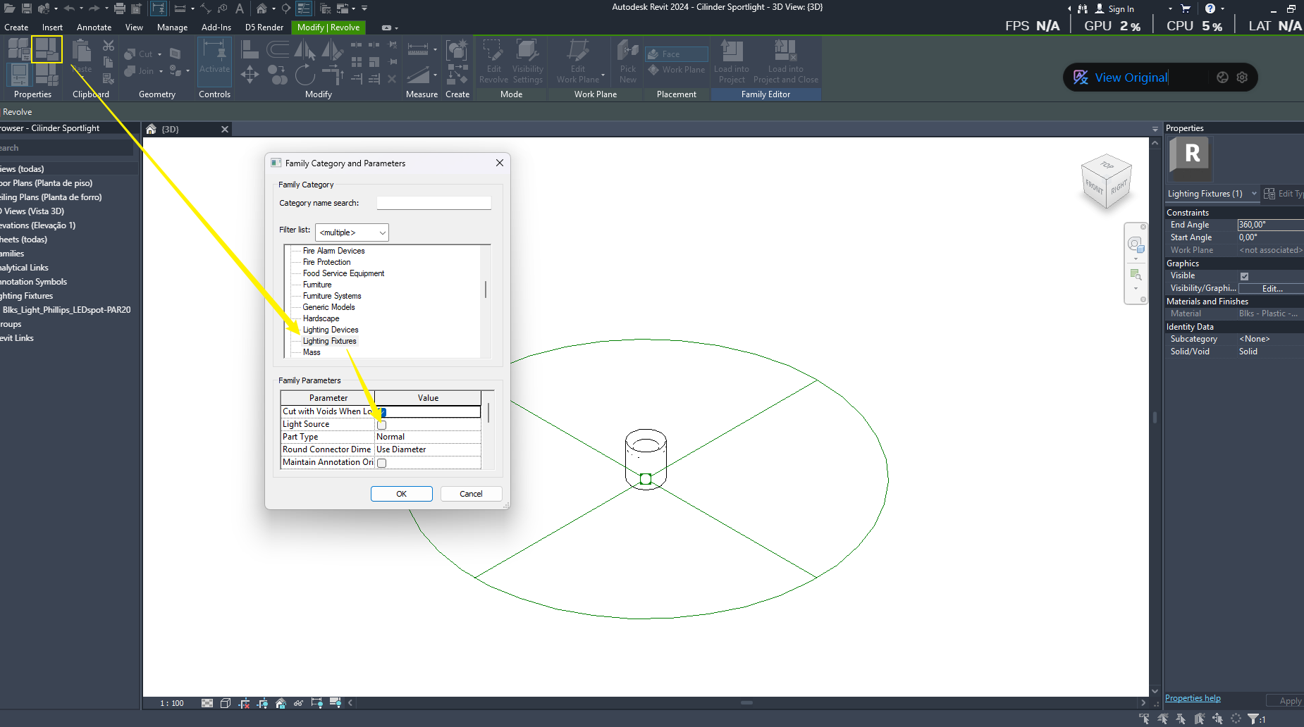

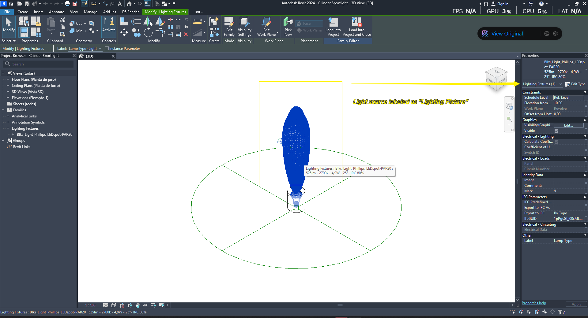

  1. The Light Source Issue - This issue stems from your model (family) and not a D5 issue. Anyway, it seems that your light source is labelled as “Light Fixture” instead of “Light Source”, I deleted it and replaced it with another Light Source, and it is syncing normally after clicking “Sync Lights”
