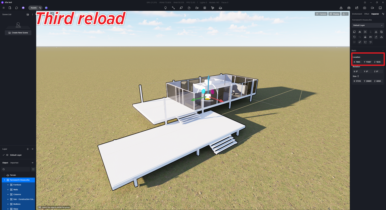

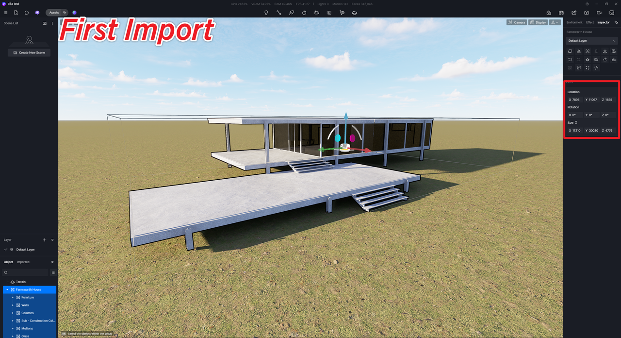

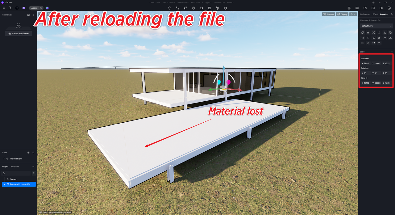

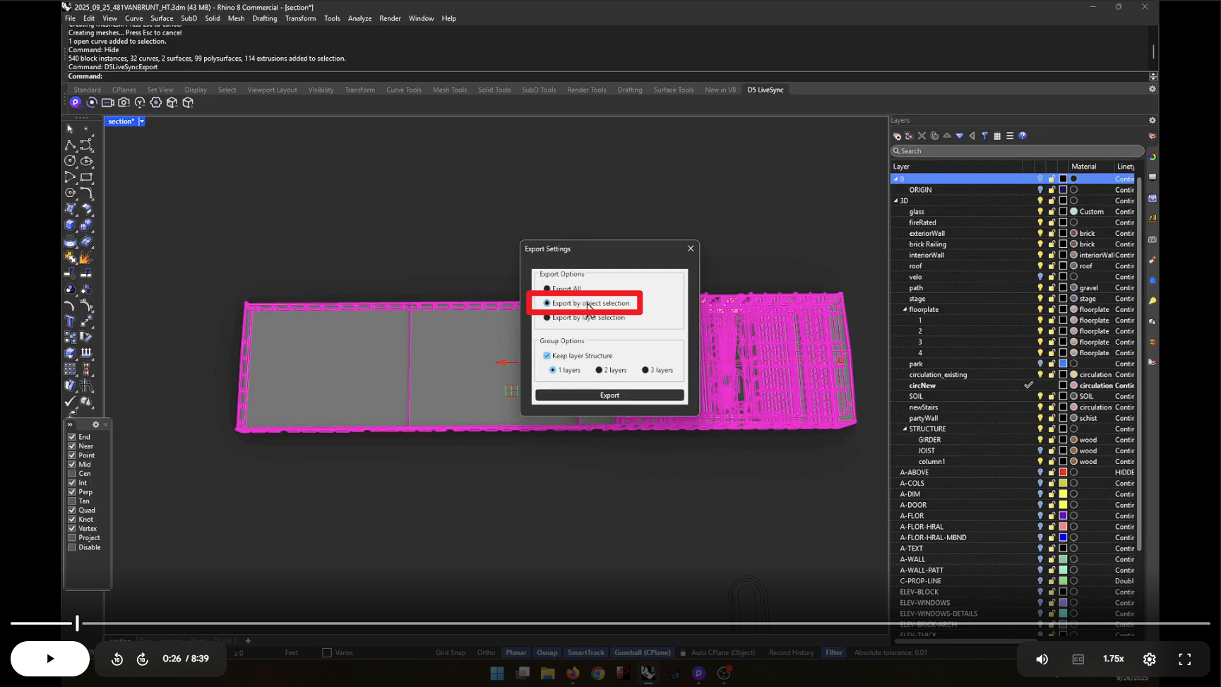

unfortunately we are finding the ‘replace from local’ d5a function to not be reliable. we are exporting from rhino 8 and each time we want to update our model, we lose most of our material choices, and the z position will often change. The bounding box of our model has not changed, but yet after syncing coordinates, the model will have moved. also to our frustration, sometimes we cannot sync coordinates, as perhaps there is some hidden item in our d5a model that has no geometry and cannot by synced. i’m not sure why something with no geometry would even be exported in the first place.
i am exporting a .d5a from “object selection” and using layer 3 groups.

hi Clov, thanks for your feedback. Ok I now understand that exporting d5a with the original layer structure will not allow the materials to be saved. exporting without this layer structure also seems to be solving our misalignment issue.
first of all here is a video of the problem that was happening, this is showing me replacing the same .d5a file but they both have layer structure.
now that you have explained the known layer issues, i did some other tests where i add an extra piece of geometry outside the main geometry to see if that will misalign. i try this both exporting “all” and “object selection”. in both cases, the .d5a does not move.
Opening a fresh file and doing these tests, it seems to work ok. but our file had lots of geometry, and we had two people working on this file, so i’ll have to keep testing to see if this works, as our file grows.

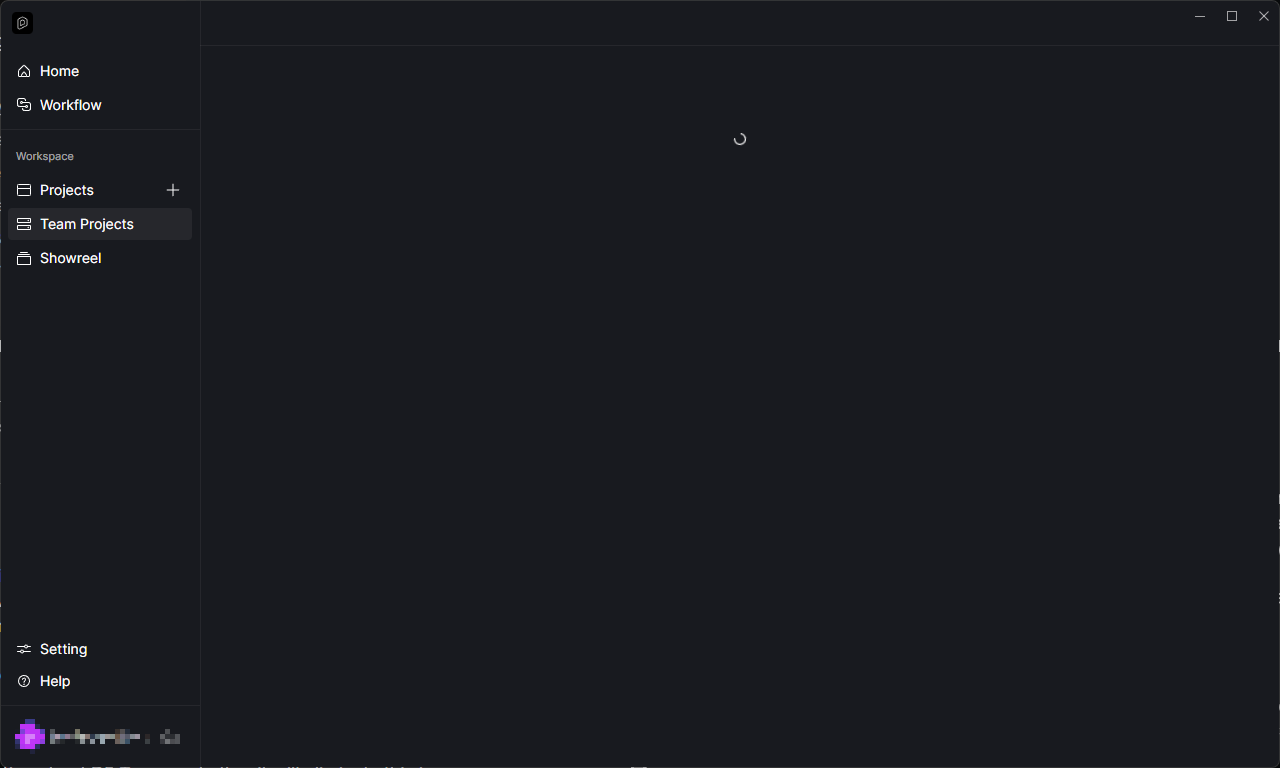

As for your question about D5 Teams, whether it will eliminate this issue.
  • Yes, as long as your team is working in the same LAN Connection and the Team Library Deployment is successful, then the files can be opened on any device with your Teams Identity account.
  • Team projects will appear here
  • If you’re not working in the same LAN, then you may need to set up a NAS
Team Library Deployment | User Manual

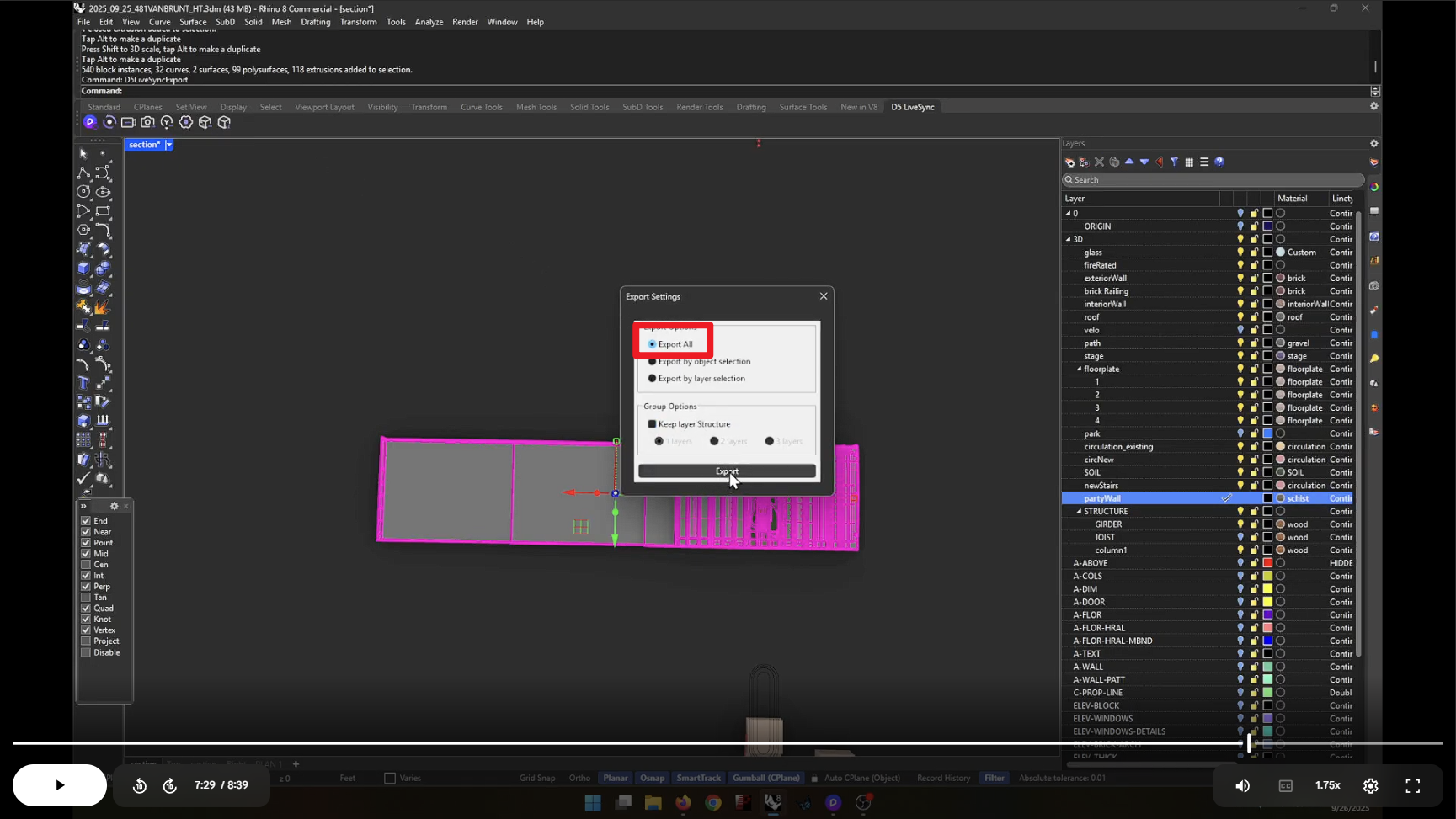

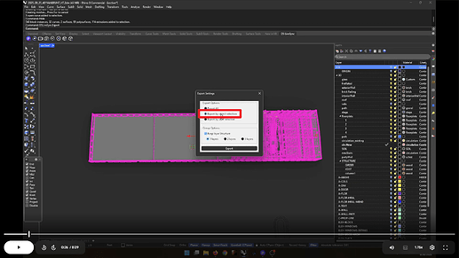

Hi @hst472
There are certainly plans in optimizing the cloud storage workflow but there’s no specific timeline as to when it will be officially implemented.
About your question, I did check the first 3 videos you’ve provided in the drive link. I noticed in the first video, your first export, you have selected Export selection, and in the second export, you selected Export all (which will export everything present in your 3d file)
