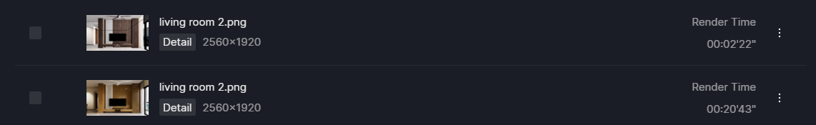

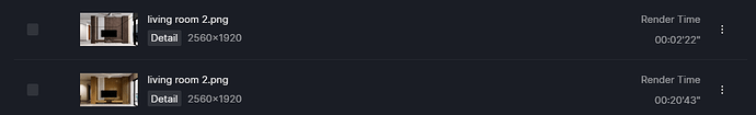

Did anyone facing rendering taking much more longer time than usually, i render same effect in same scene but the time for rendering takes 3 times longer than usual for a 2K image.

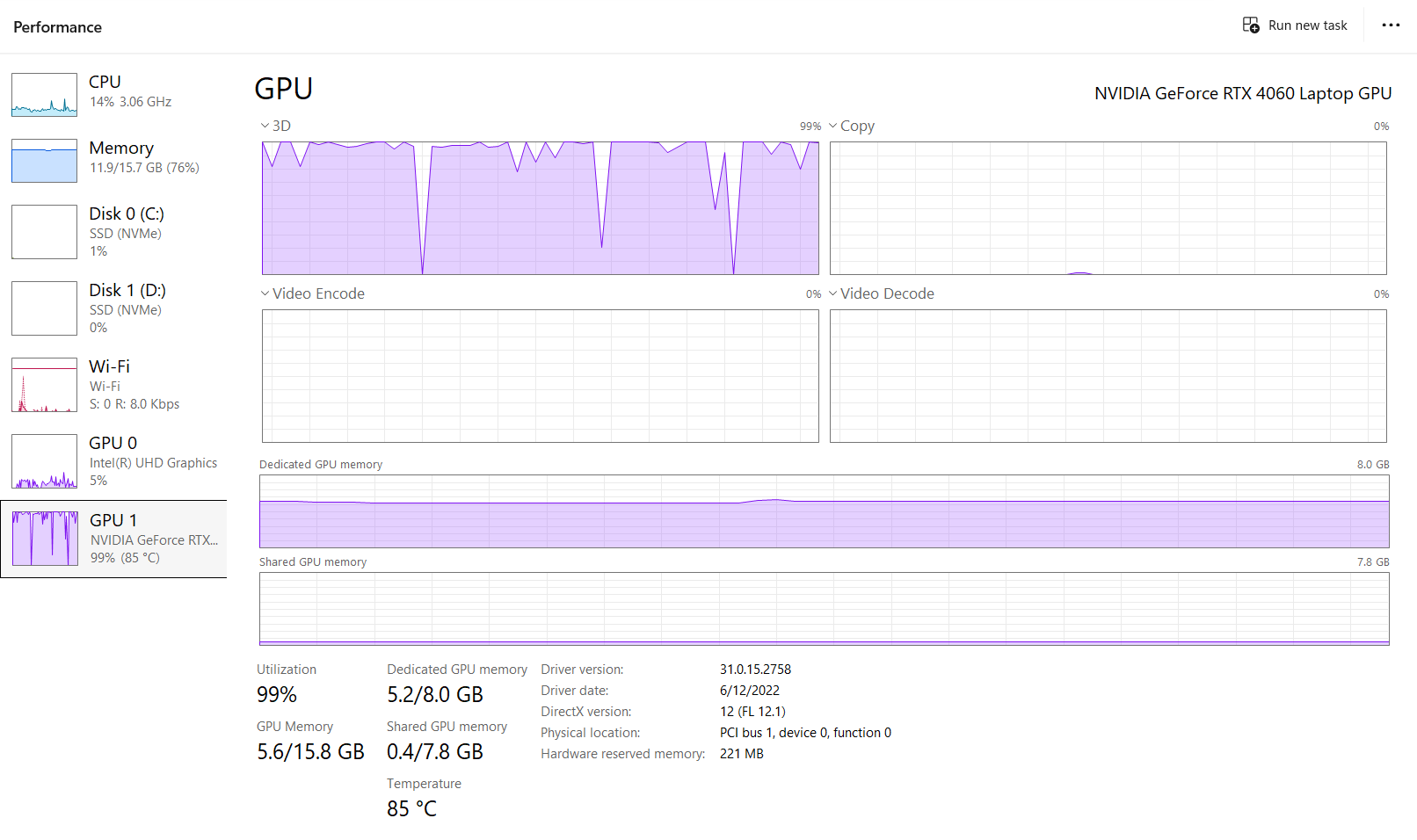

- Can you share your VRAM Info while rendering?
The one with Render time with 2mins is 10mb, while the one with 20mins is only 9.33mb. The D5 file is 1.60gb. I tried on 2 different project, both happen the same.

Please try to update your drivers, it seems that you are still using 527.58 which was released last 6/12/2022.
After updating, you can try again and if the issue persists we may need to collect both of these files + your log file so we can troubleshoot this further
