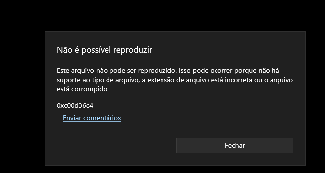

another problem guys… my renders are not saving the video output when using render queue… a 8 second take is rendering but generates a small file… it should be around 170 mb
this message is displayed when i try to play the video
This file cannot be played. This may be because the file type is not supported, the file extension is incorrect, or the file is corrupted.0xc00d36c4

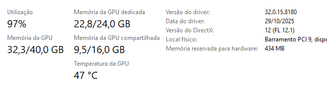

Hi @NOG_the_DOG

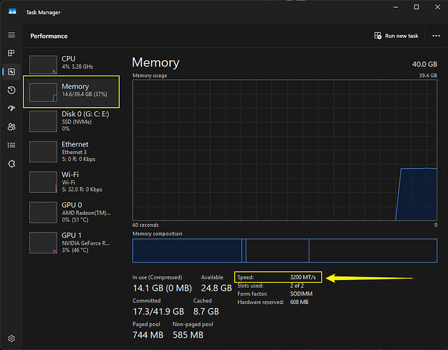

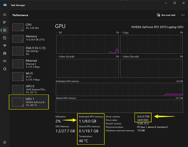

Thanks for the details. I noticed from your screenshot that your VRAM usage is at 97%. When VRAM is this high, D5 Render can experience lag, freezing, crashes, or corrupted render outputs, which explains the issues you’re seeing with this particular project.
To resolve this:
  • Reduce file size by optimizing foliage, lighting, and models.
  • Lower polygon counts in your modeling software and remove any hidden/unnecessary faces or surfaces.
  • If you have numerous camera scenes, consider splitting your project (e.g., create duplicate for separate interior and exterior scenes) to make it easier to manage and delete unseen objects.
  • Monitor GPU memory usage — if it exceeds 90%, similar problems are likely to continue.
You can refer to your VRAM usage screenshot here for guidance:
yes this file is very heavy, but i always work on files with this level of gpu use
