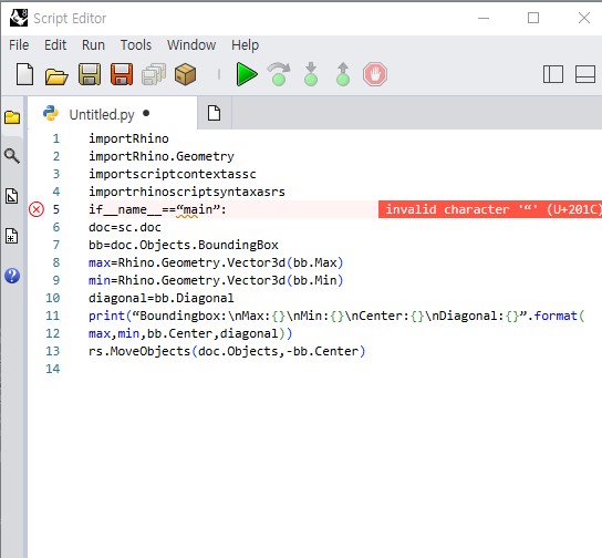

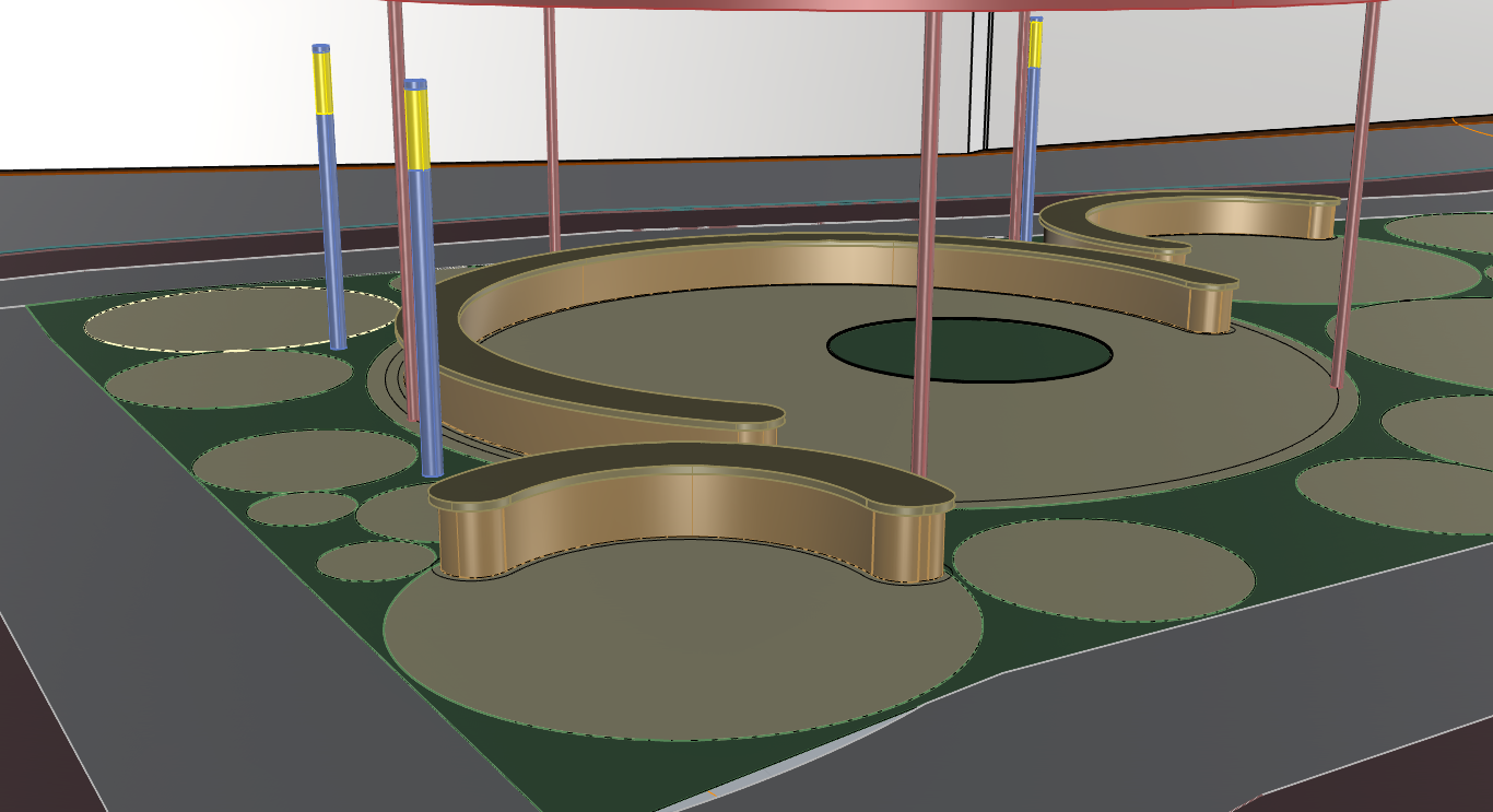

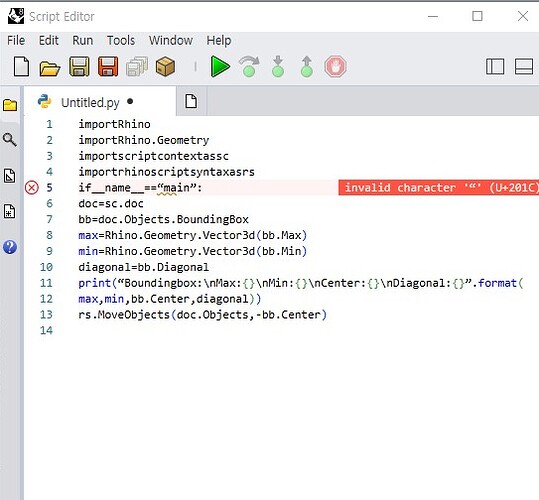

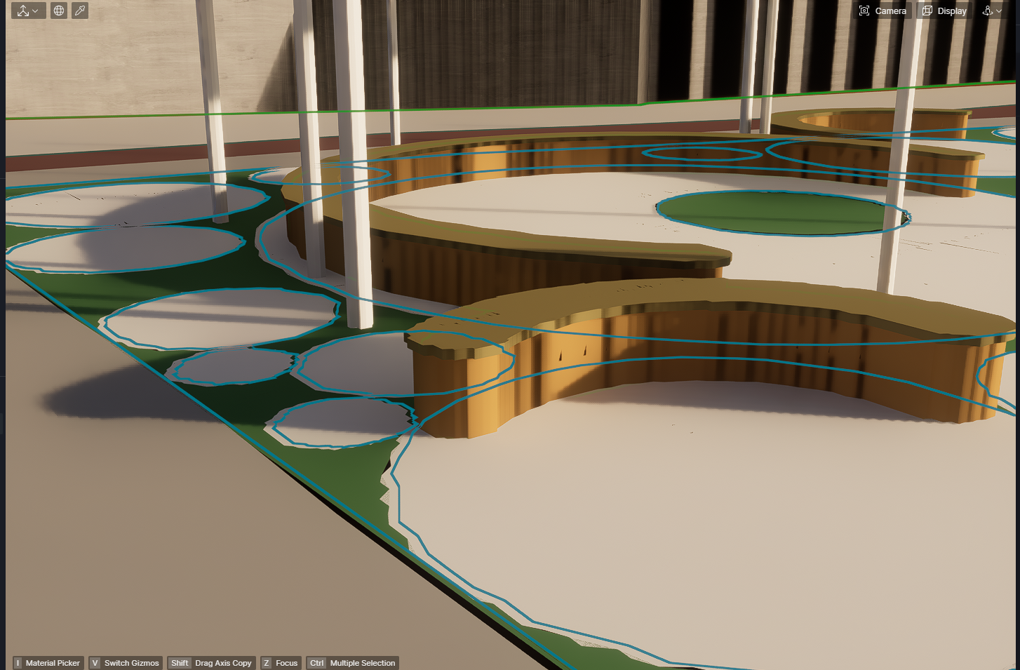

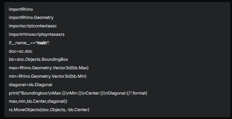

“Even though I’ve completed the upgrade on NVIDIA, models that work fine in Rhino don’t display correctly once imported into D5. I pasted the exact code you provided regarding the round corner issue, but it doesn’t seem to be recognized and I can’t figure out what went wrong. Could you please help me?”
“I’m not very skilled with these programs, so I would really appreciate your help. If possible, I’d like to share my file with some experts to ask whether it renders properly in D5.”

Hello try to press F1, i.e. the program is set in the Smooth visule in F2, check this
Then if you have a finished project with its materials, you have to open D5 with New first, make it load set the external light not automatic, usually I put 0.5 or 0.6, it depends if you are outdoors even less or those values I indicated before if you are inside.
Then adjust the sun with cool or warm color I use an HDRI. when I use an HDRI I lower the light of the image a little. Once this is done, I synchronize the work from the program you use, and then save it in your work folder.
This can be a beginning of a work without having any surprises.
