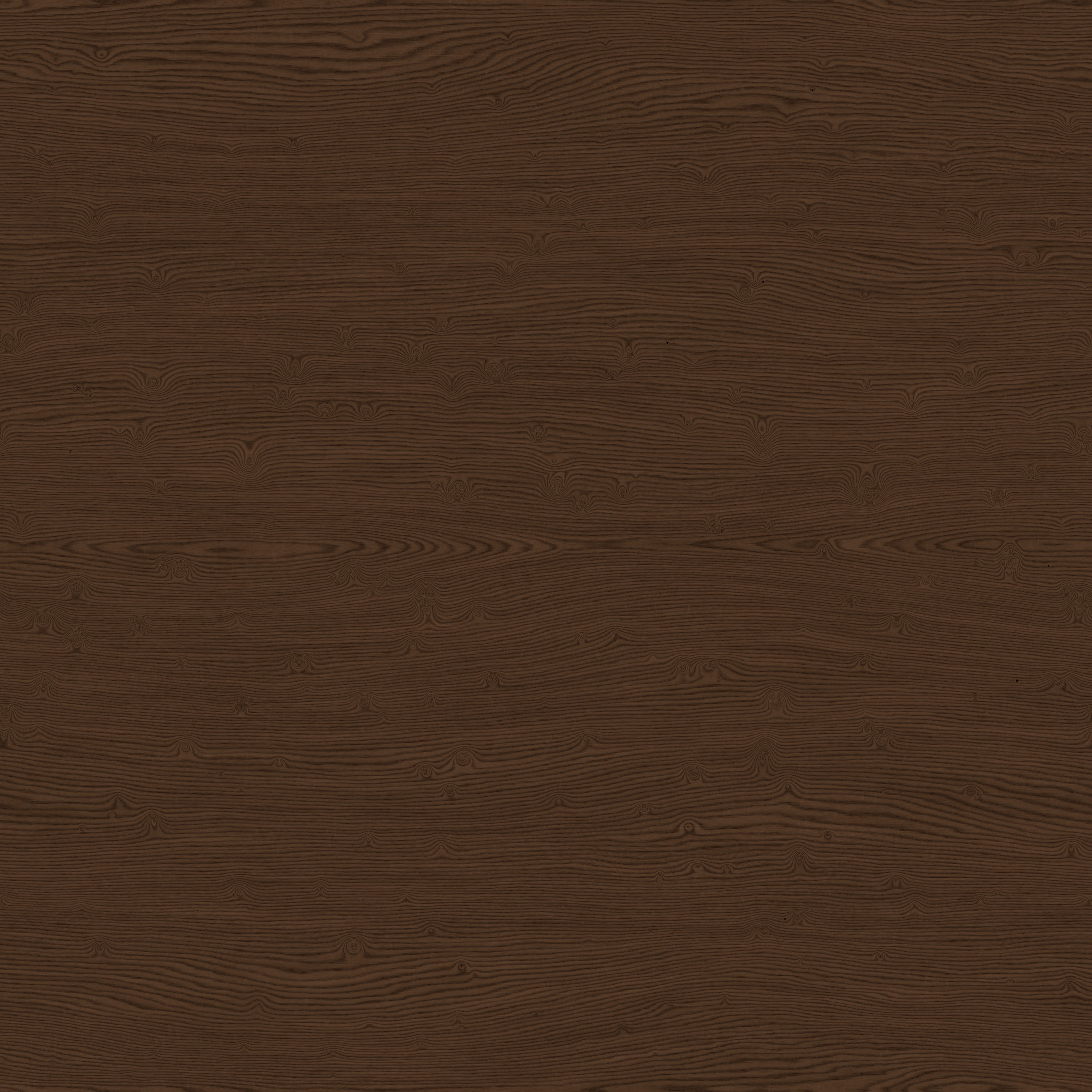

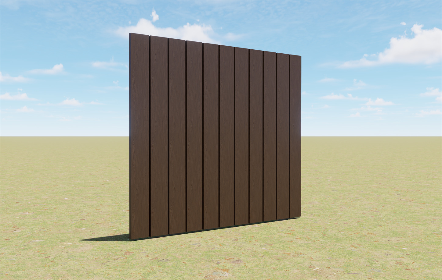

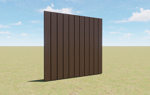

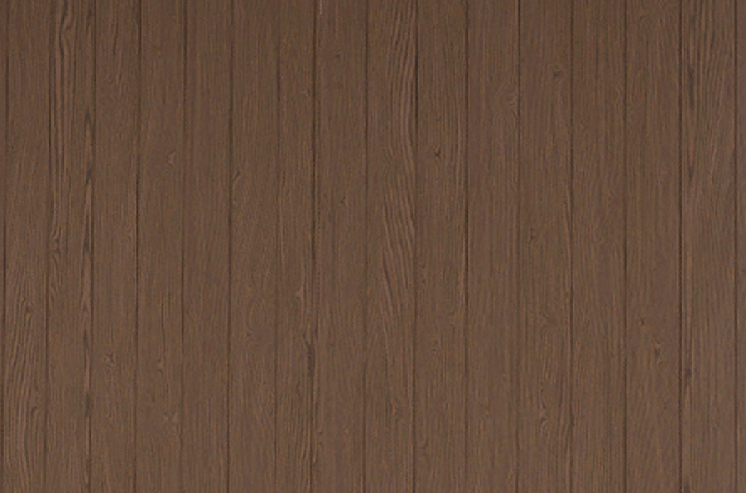

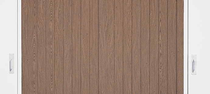

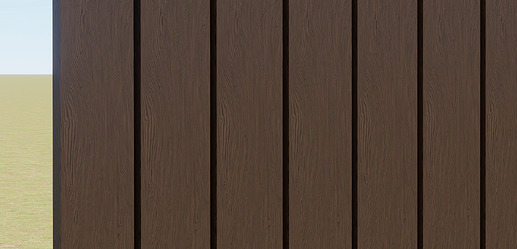

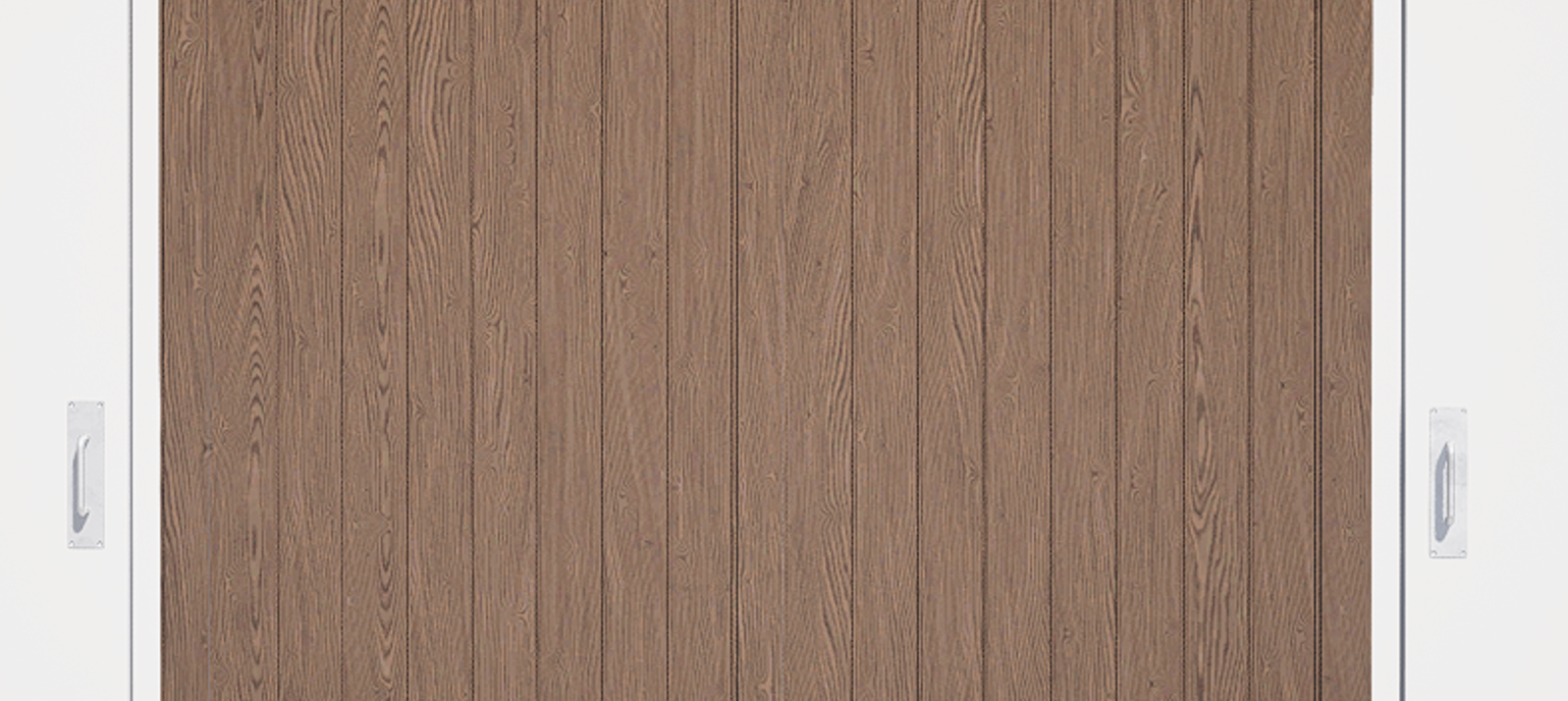

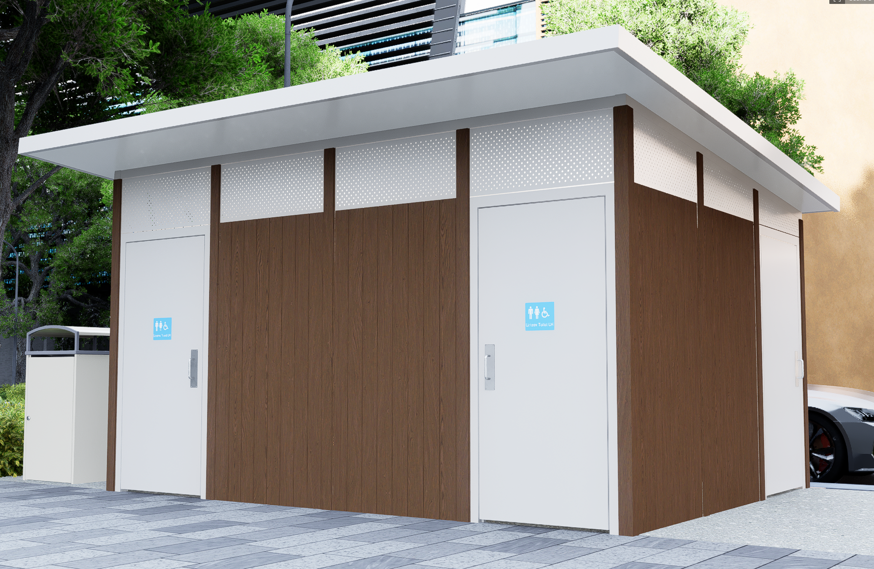

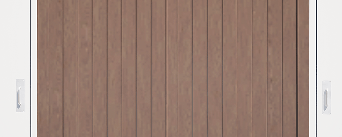

i’m having a problem, when i render the texture became low resolution than the viewport. Originally it is 8k, i tried to lower it to 4k and 2k. same result. i also turned off the SR on the widget. check the forum i also make sure that the auto exposure is off. any help?
viewport zoom in
render zoom in

Is this from the online library? If so, can you share the name of the asset? If it’s an imported image, can you share the original texture image?
4k customized it from substance painter

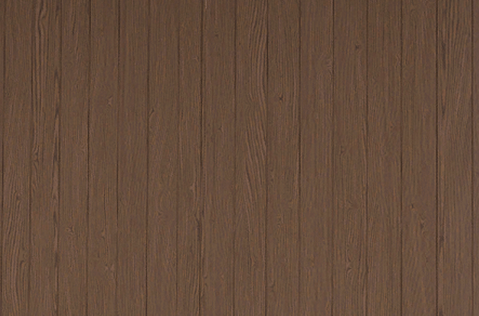

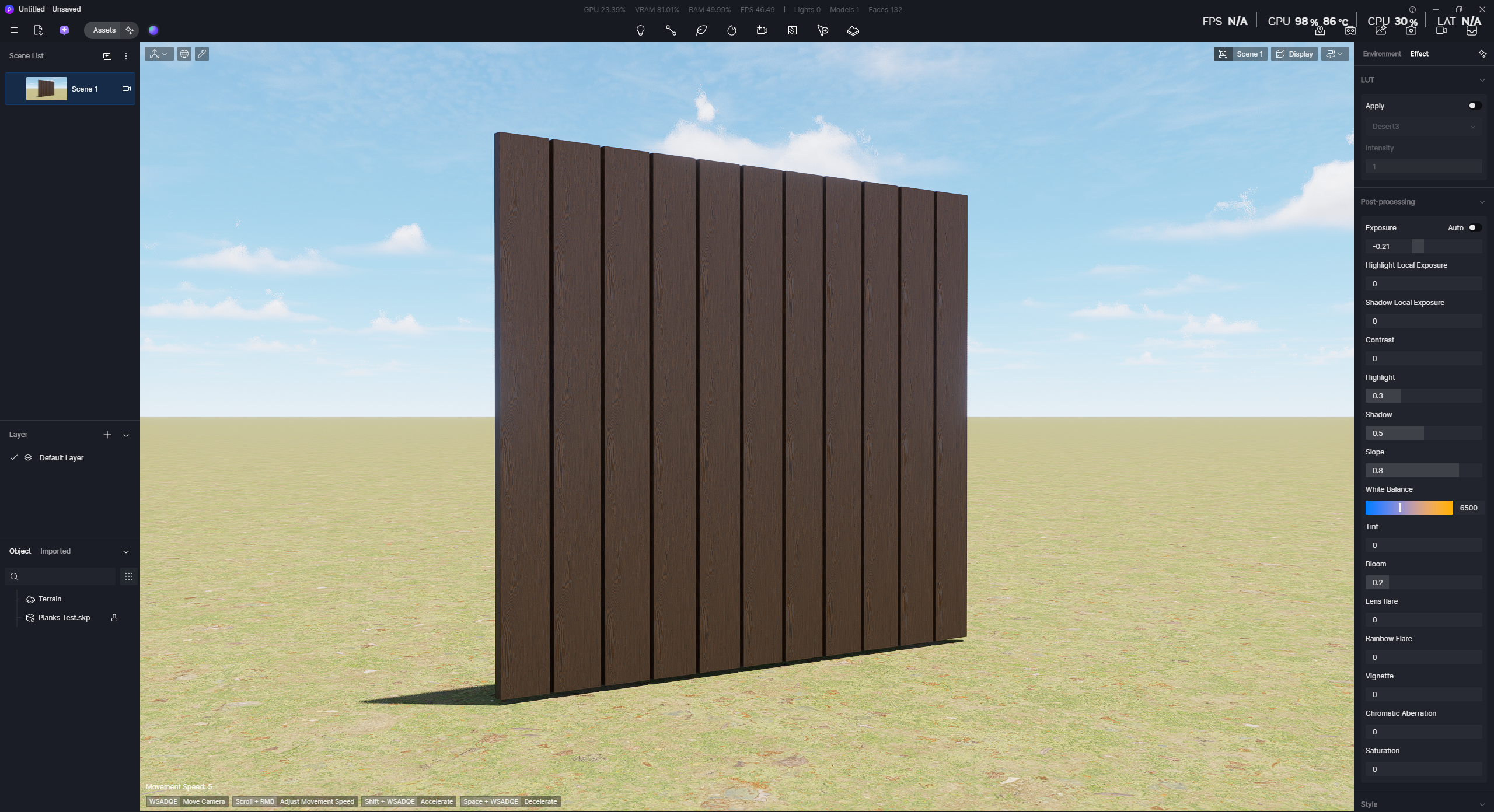

I tested it with a simple model, and I can’t seem to replicate this issue. Does this only occur in this specific file and to this specific texture you have imported?
  • What’s your D5 Render Version?
  • Your NVIDIA Graphics Driver Version? Please update if it is outdated
My test:
