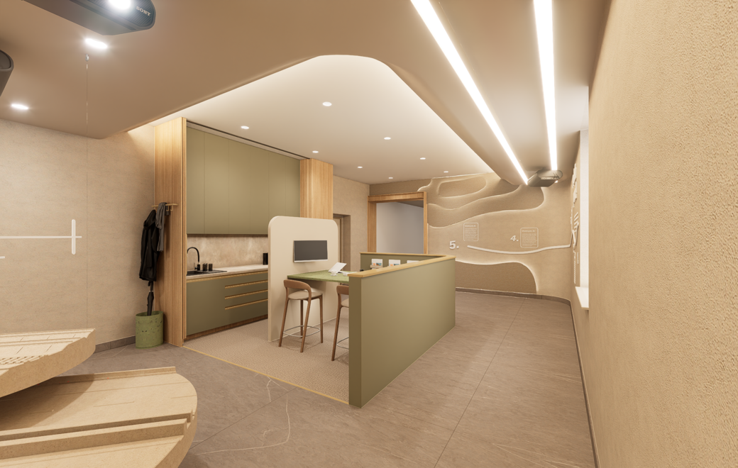

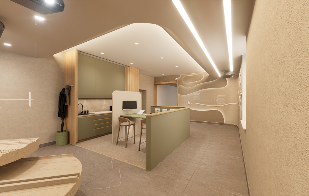

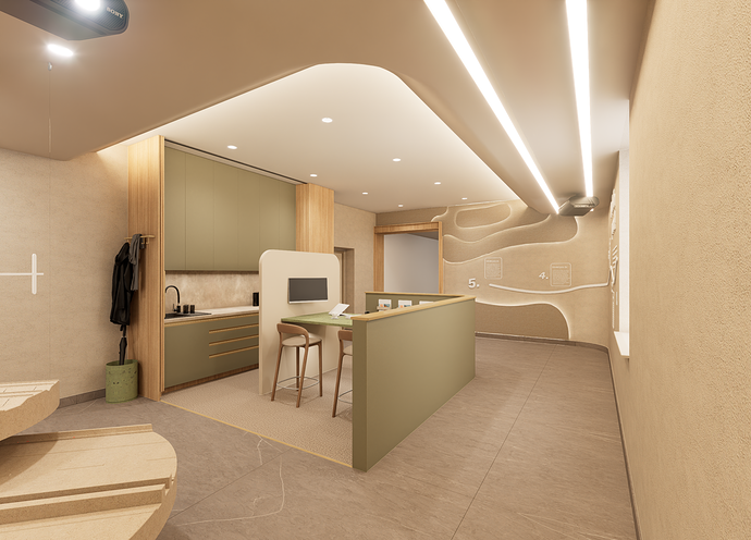

I have been trying to work out why does D5 create this strange effect on the lighting of the design feature on the back wall. It looks similar to what I got when I tested D5 SR. But these results are with various setting in path tracing. I tried to turn it off too but it didnt help. The image names are the setting for each rendering. The best result was with GI and Reflections set to 3 and SPP to 64. When I tried SPP at 512 it didnt really improve that much but the render time shot up.
I know I am missing something simple here, please help me out.
Thanks a lot!
No PT
PT - GI1 REF 1 SPP 64
PT - GI3 REF 3 SPP 64
PT - GI3 REF 3 SPP 512

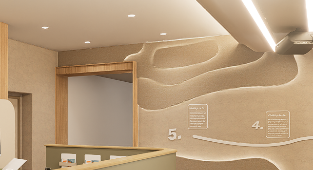

Idk why it didnt attach the file in full res. Its exactly what you noticed. in full res the light strip looks really blurry. The edge blends with the light.
Ill try to disable the cast shadow option:)
INT3_PT_GI1_REF1_SPP64_33secs
